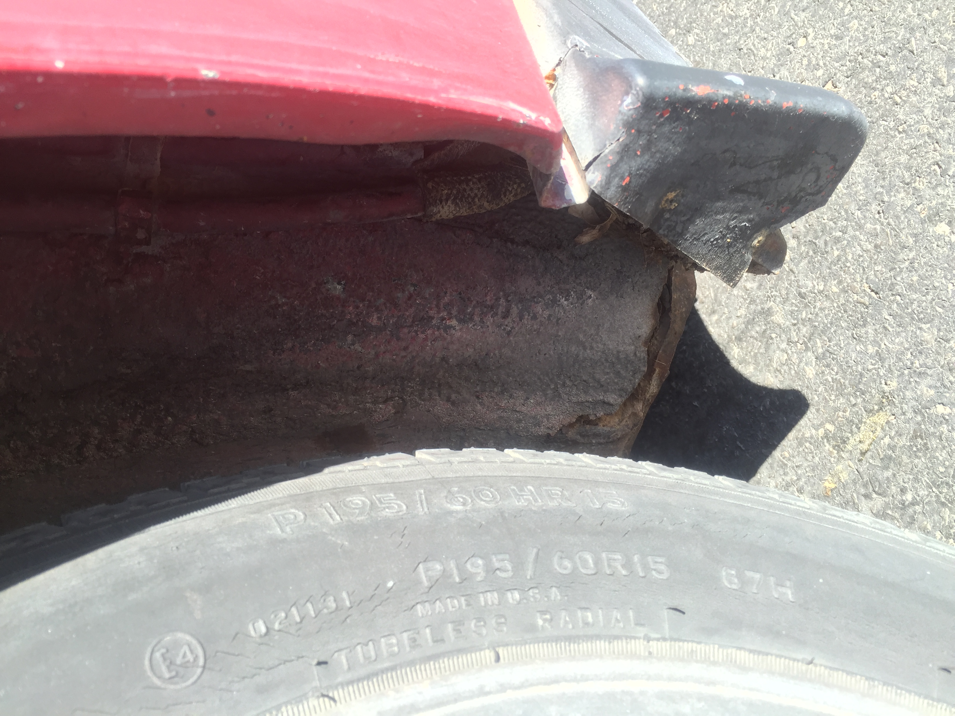

Trying to figure out how to make the pictures smaller off of the phone.
Drivers side wheel well corner

Jeff Bowlsby   With all that context...sell it or part it. It wi...   Jul 18 2016, 09:48 AM
Gustl   With all that context...sell it or part it. It w...   Jul 18 2016, 09:57 AM
DirtyCossack   I think it really depends on the condition of the ...   Jul 18 2016, 10:16 AM
lcjo73914   I think it really depends on the condition of the...   Jul 18 2016, 10:38 AM
DirtyCossack   Also, if it is somehow rust free, the tub could be...   Jul 18 2016, 10:21 AM
KELTY360   :wttc: First off, it looks like there are plenty...   Jul 18 2016, 10:28 AM
lcjo73914   :wttc: First off, it looks like there are plent...   Jul 18 2016, 10:38 AM
barefoot   Remove the rocker panels and look for rust where d...   Jul 18 2016, 10:43 AM
Lemmonhead   Remove the rocker panels and look for rust where ...   Jul 18 2016, 10:54 AM
blackmoon   :wttc: Good luck with this endeavor, not for the ...   Jul 18 2016, 10:45 AM
lcjo73914   New member to the 914 world. I just bought this ...   Jul 18 2016, 10:57 AM
rudedude   How old is your son? Mine started on his 914 proj...   Jul 18 2016, 10:57 AM
mgp4591   Patience is definitely the key here. If the car is...   Jul 18 2016, 11:49 AM
PanelBilly   Go for it. Don't spend any $ and just hav...   Jul 18 2016, 12:42 PM

Cairo94507   :wttc: Regardless of what the end result ends up ...   Jul 18 2016, 01:03 PM
Mark Henry   Since it's a LV car the chassis may be in surp...   Jul 18 2016, 01:39 PM
ripper911   Since it's a LV car the chassis may be in sur...   Jul 18 2016, 05:40 PM

DirtyCossack   If the chassis is solid, you can do it for $4...   Jul 18 2016, 01:53 PM
Mike Bellis   If the chassis is solid, you can do it for ...   Jul 18 2016, 09:13 PM
DirtyCossack   If the chassis is solid, you can do it for ...   Jul 19 2016, 10:09 AM
Chris914n6   If the chassis is solid, you can do it for ...   Jul 19 2016, 03:44 PM

worn   New member to the 914 world. I just bought this ...   Jul 18 2016, 04:53 PM
rhodyguy   4-5k <_< . No way.   Jul 18 2016, 05:30 PM
messix   trailer it to the east coast and triple your money...   Jul 18 2016, 05:50 PM
Localboy808   New member to the 914 world. I just bought this ...   Jul 18 2016, 09:06 PM
Localboy808   And if you do part it out? I'm a buyer!   Jul 18 2016, 09:07 PM
Claus Graf   If the longs are good then go for it! If it i...   Jul 18 2016, 09:54 PM
rick 918-S   We need more photos to be able to assist with advi...   Jul 19 2016, 06:03 AM
RobW   :agree: Strip it down and assess the common probl...   Jul 19 2016, 06:44 AM
Mark Henry   If the chassis is solid, you can do it for ...   Jul 19 2016, 08:25 AM
mbseto   Rather than decide based on the car, decide based ...   Jul 19 2016, 09:24 AM
rmdinmd   I understand a budget, but if you spread it out ov...   Jul 19 2016, 09:46 AM
zipedadoo   I built a 1972 with my son. We did it on the cheap...   Jul 19 2016, 09:58 AM
Lemmonhead   Thanks for the replies. I can see some rust on th...   Jul 19 2016, 10:12 AM
914forme   Thanks for the replies. I can see some rust on t...   Jul 19 2016, 10:25 AM
