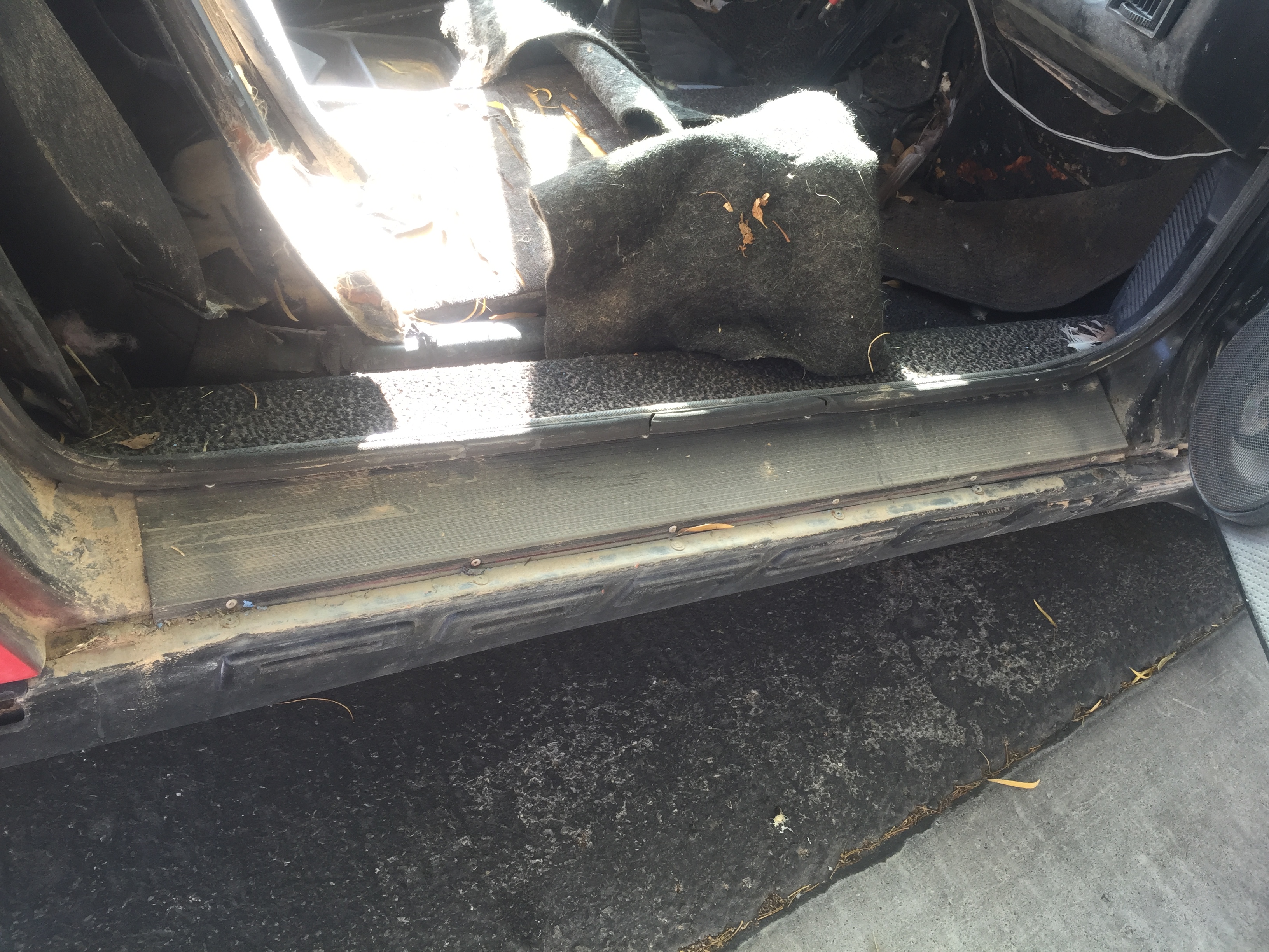

Thanks for the replies. I can see some rust on the riverside wheel wheel. Looking under the car I can see some rust on the floor pans, can not determine yet the depth of the rust. Rockers look good. For the life of me I cannot figure how to open the rear trunk. No buttons, there is not a wire hanging down no visible levers.

Your rockers look great, unfortunately what you are seeing is the rocker covers. You will have to go along and remove all the rivets, and bolts to get behind them. Then you can see what you have.

Lemmonhead   Passenger side door and rocker   Jul 19 2016, 10:57 AM
