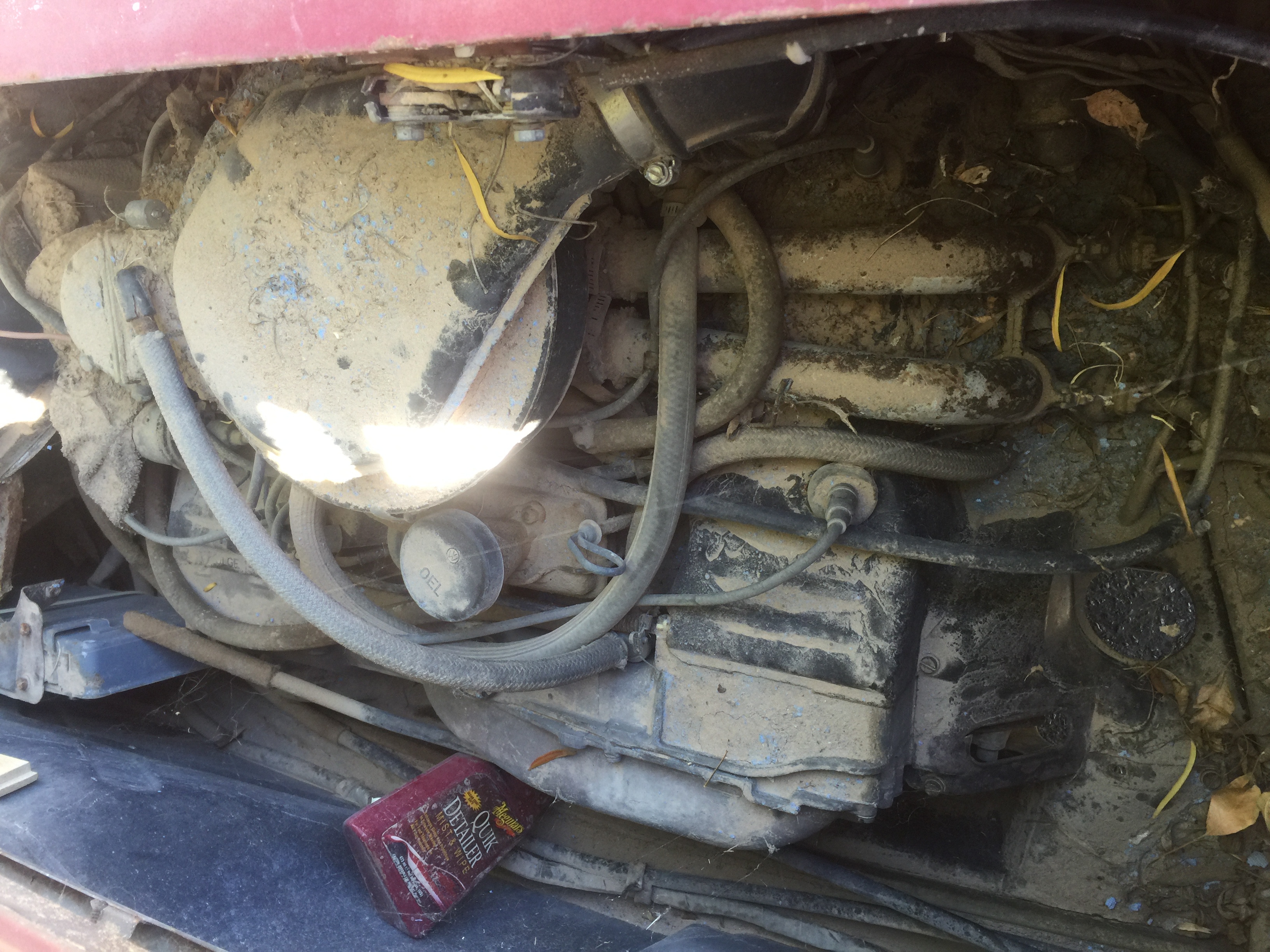

Lemmonhead
post Jul 19 2016, 10:33 AM
Posts: 9
Joined: 17-July 16
From: Las Vegas
Member No.: 20,195
Engine bay full of dirt and sand

Lemmonhead   Engine bay full of dirt and sand   Jul 19 2016, 10:33 AM
