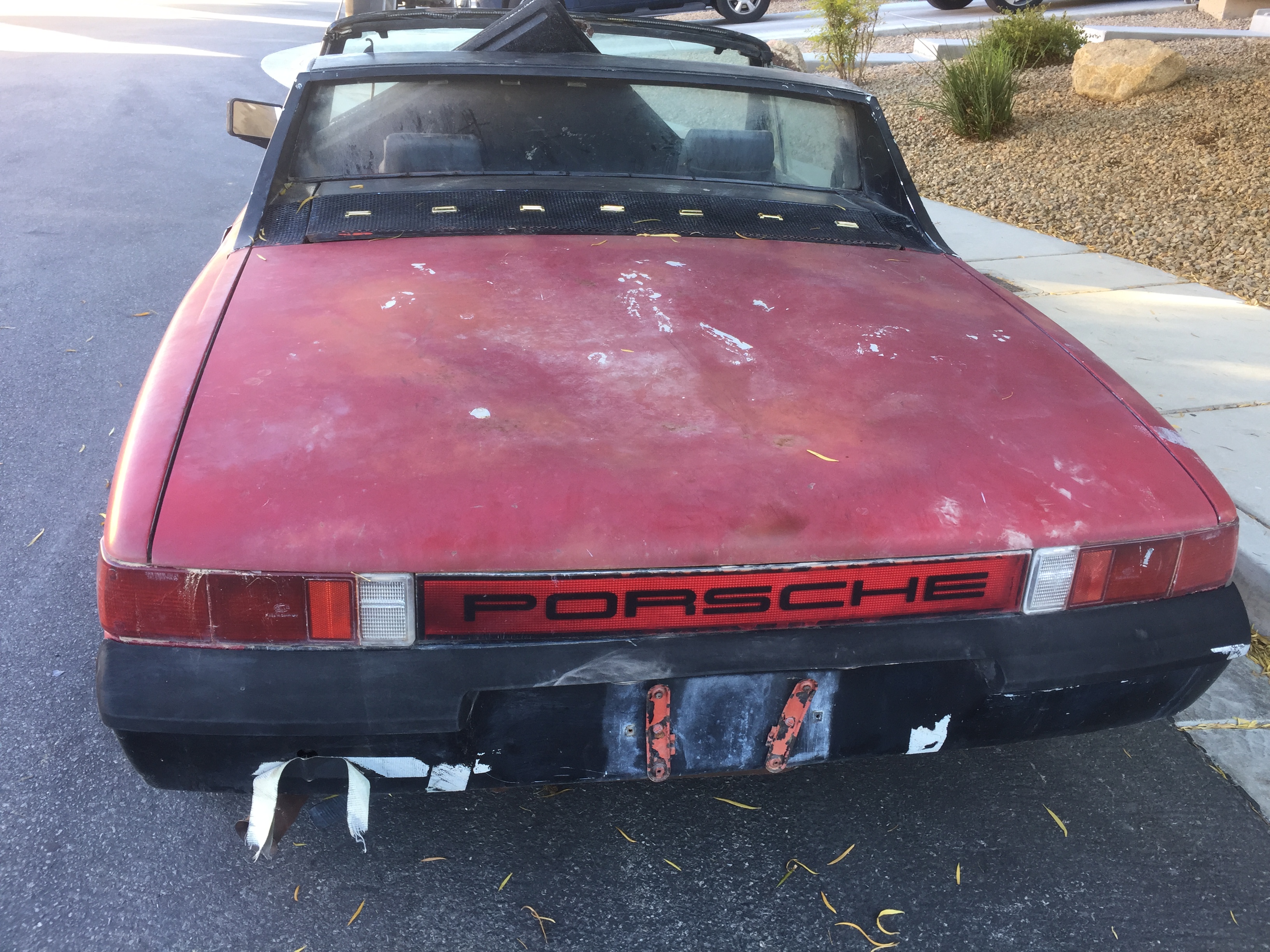

Rear view

Lemmonhead   Rear view   Jul 19 2016, 10:50 AM
