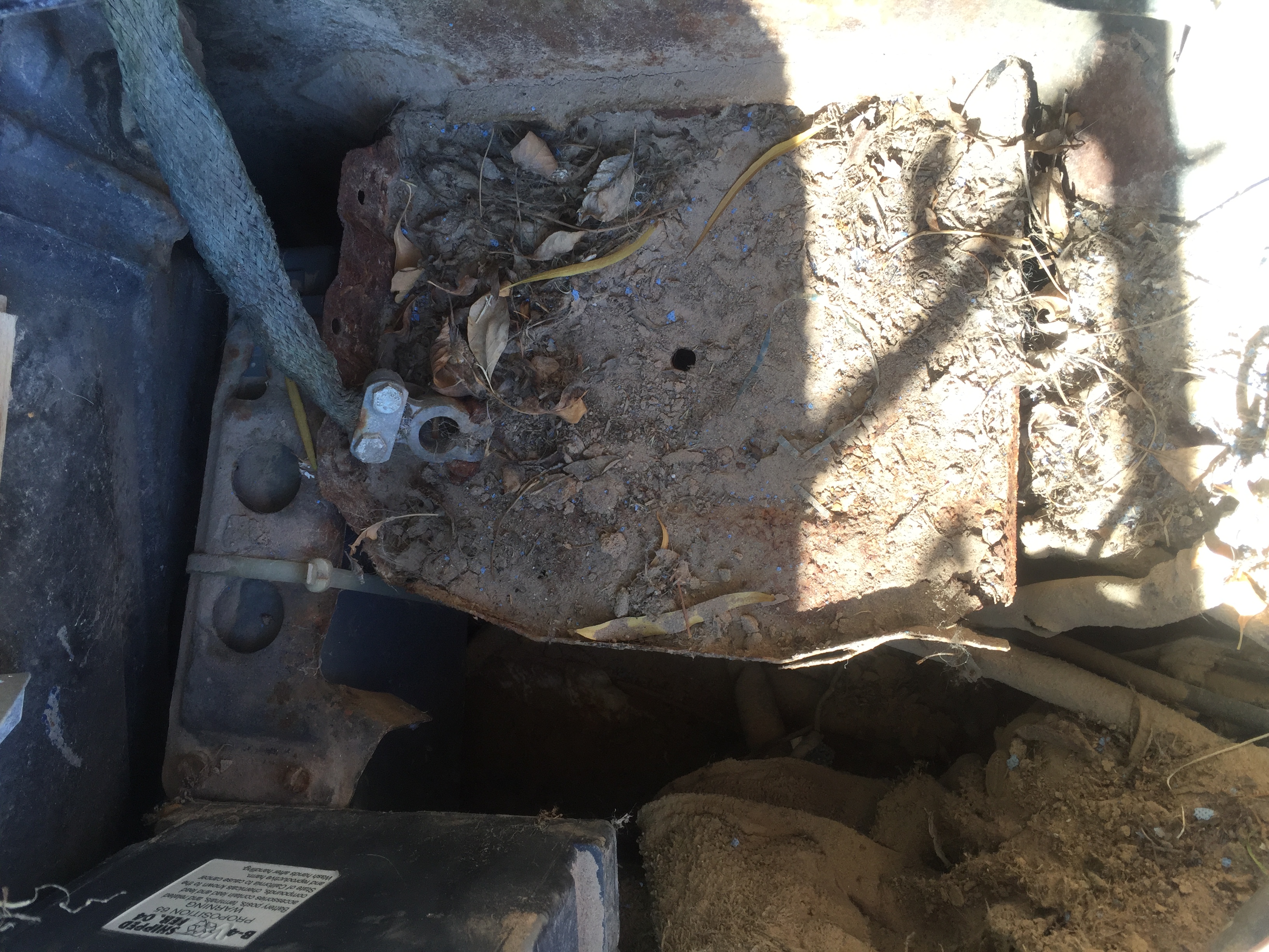

Quick picture of battery tray before I left for work.

barefoot   Remove the rocker panels and look for rust where d...   Jul 18 2016, 10:43 AM
Lemmonhead   Remove the rocker panels and look for rust where ...   Jul 18 2016, 10:54 AM

Lemmonhead   Thanks for the replies. I can see some rust on th...   Jul 19 2016, 10:12 AM
914forme   Thanks for the replies. I can see some rust on t...   Jul 19 2016, 10:25 AM
