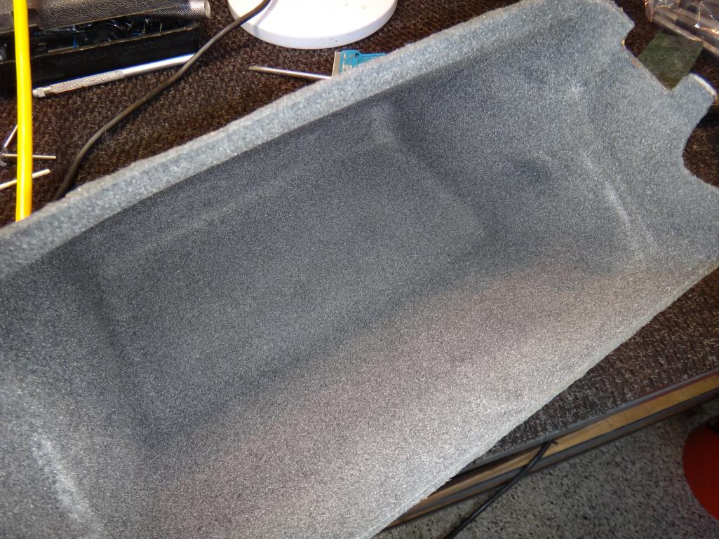

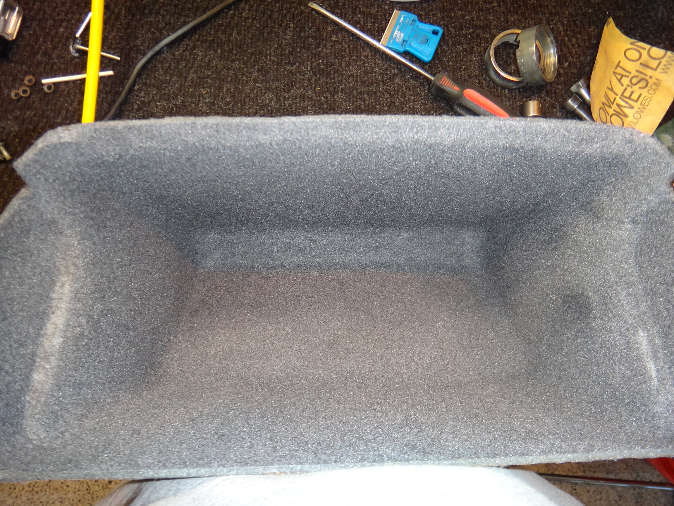

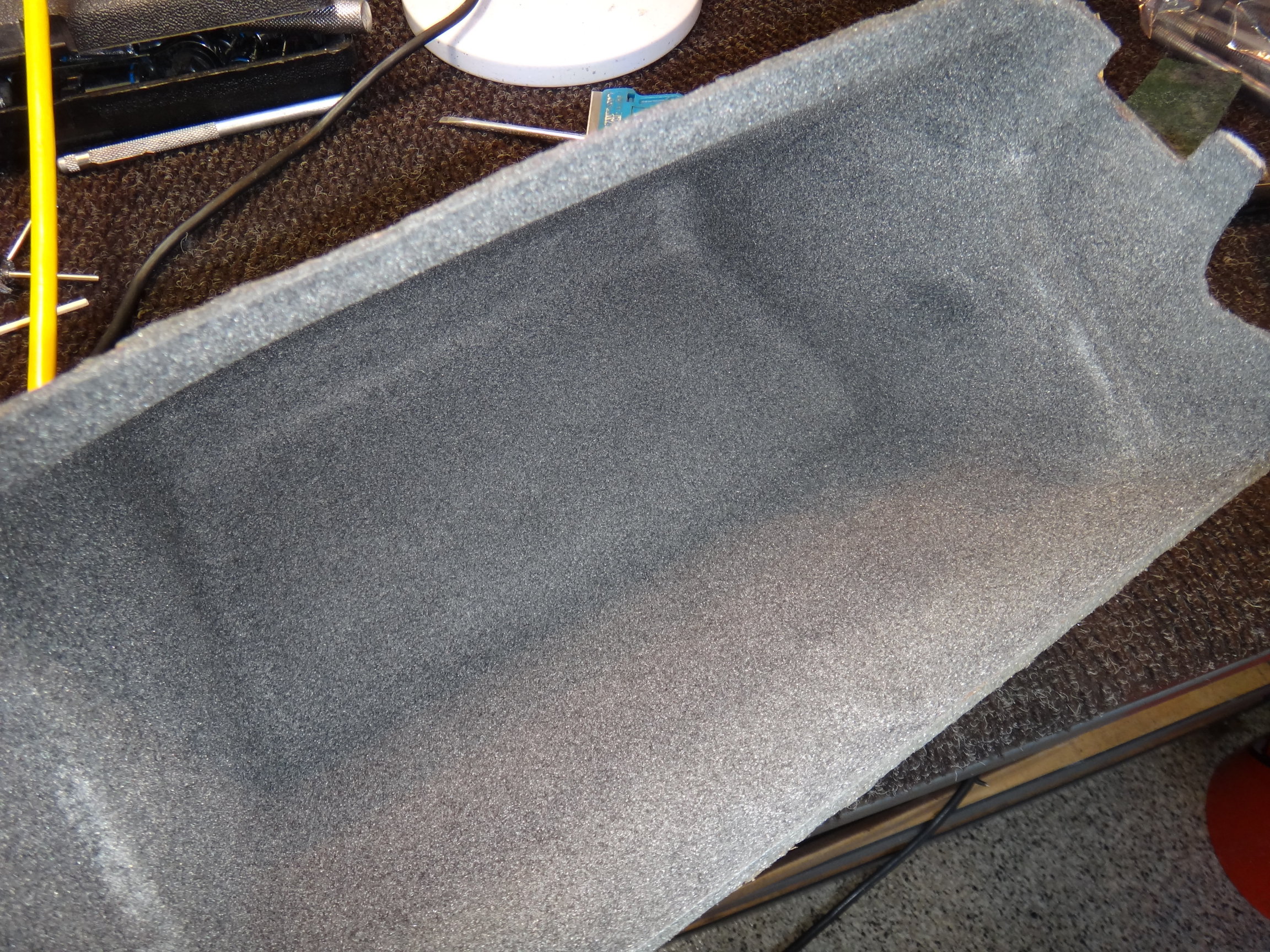

Latest craziness.....
Re-flocking the glove box.
Why do this? I guess the best answer is because you (or I) can....
Turned out great with very little effort.
A business opportunity for moi? (IMG:style_emoticons/default/welder.gif)
