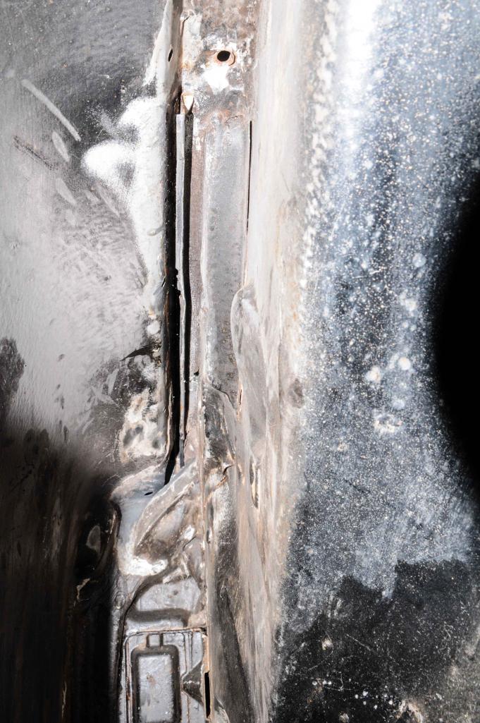

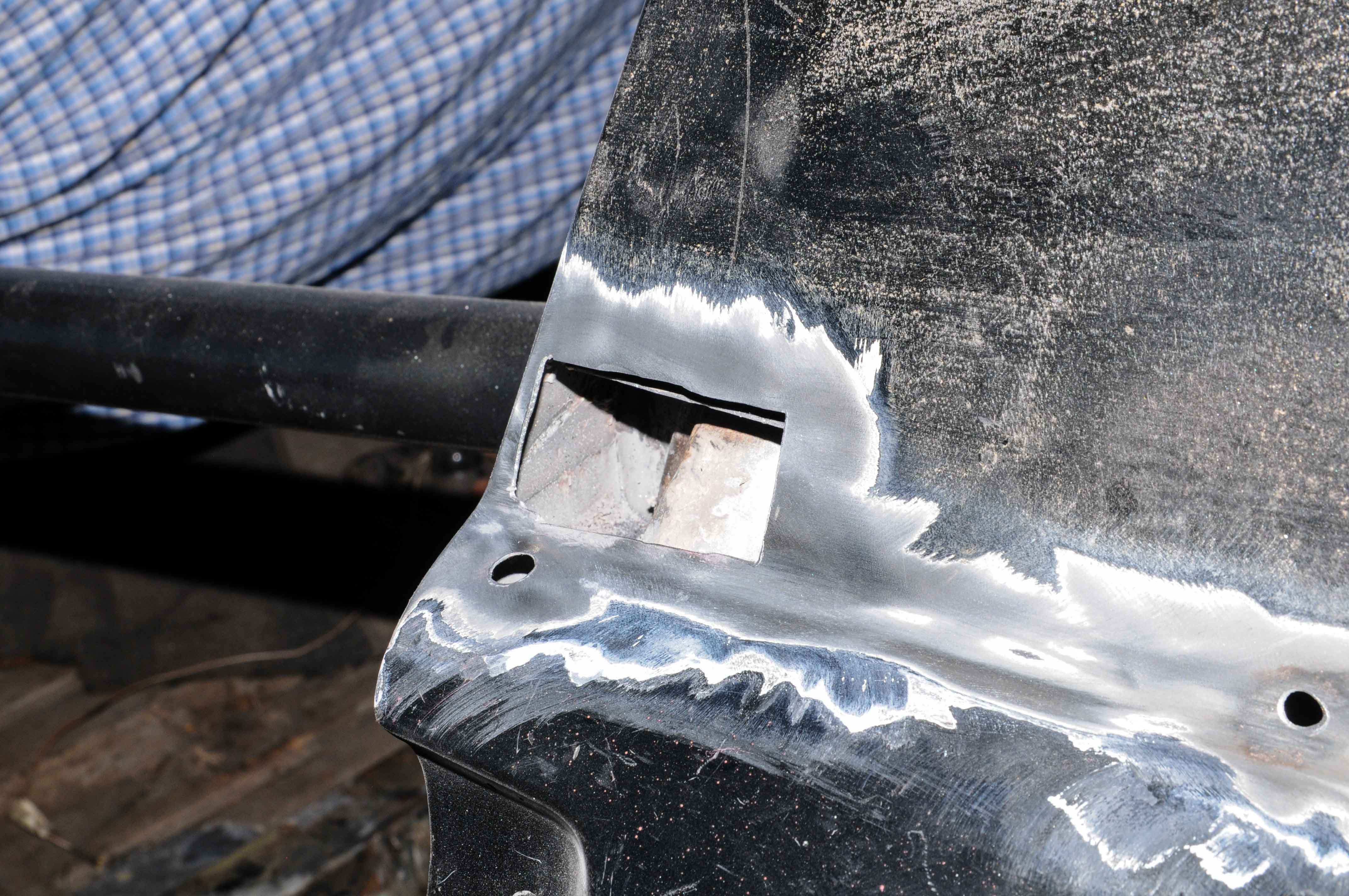

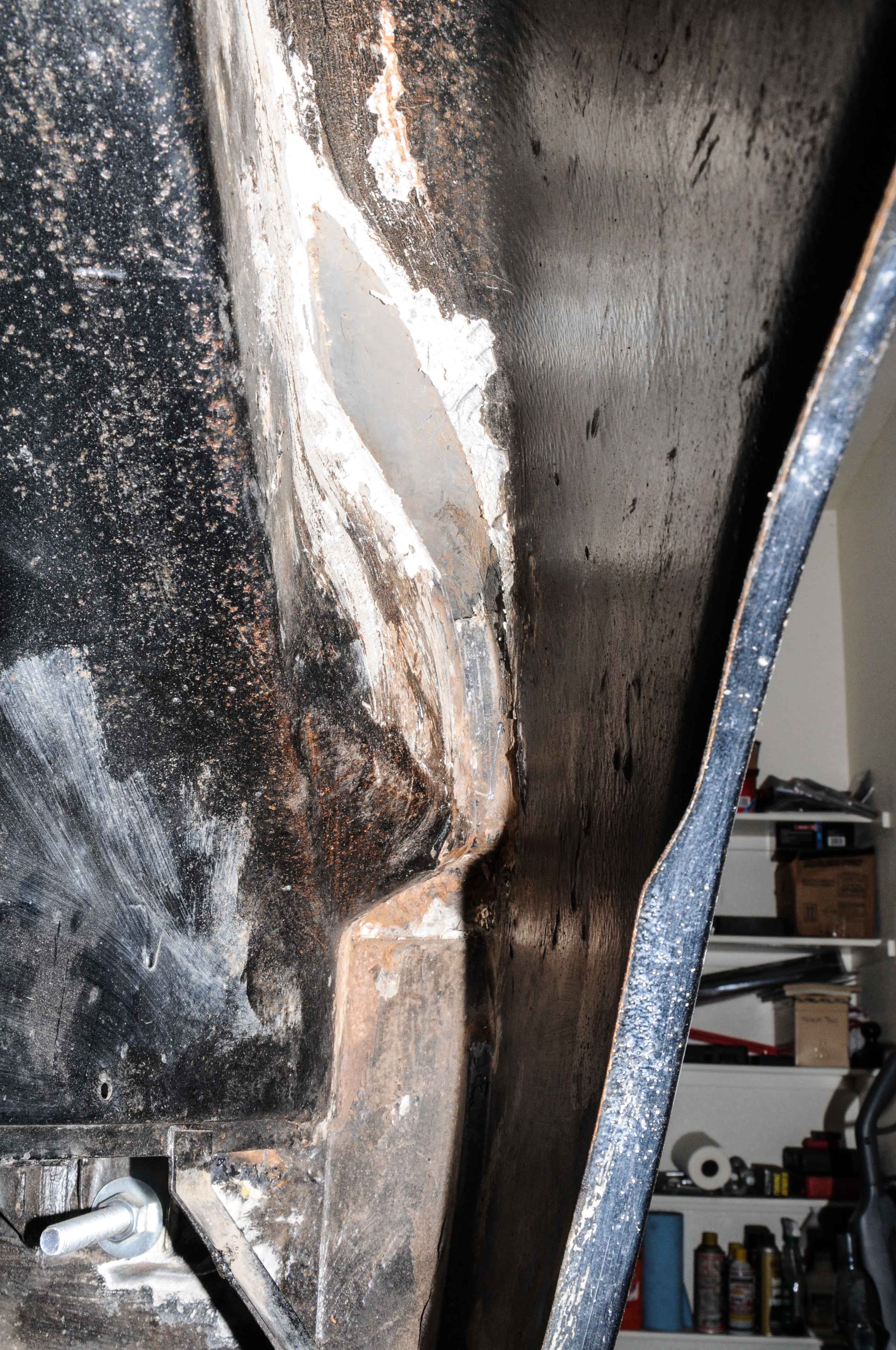

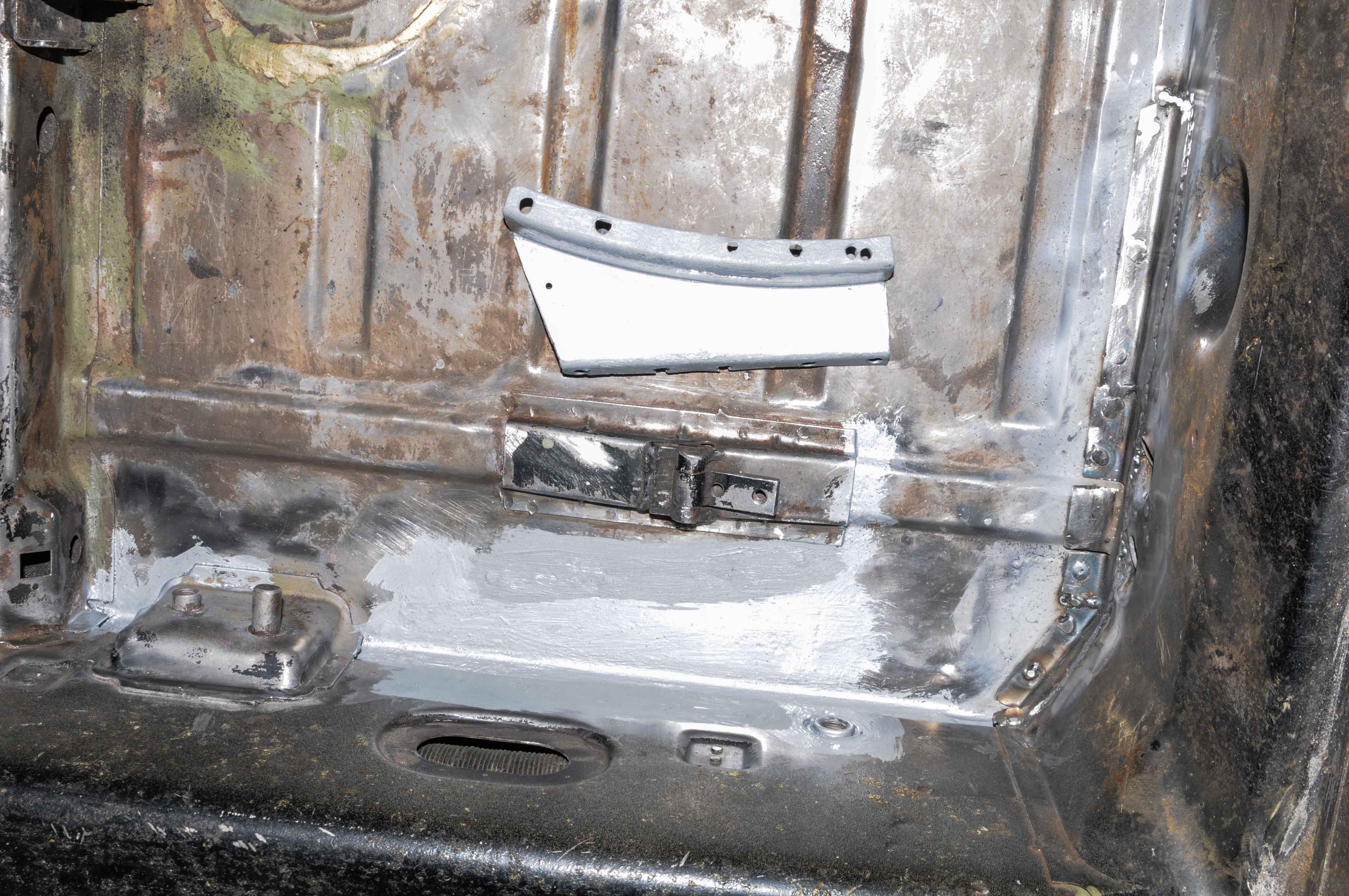

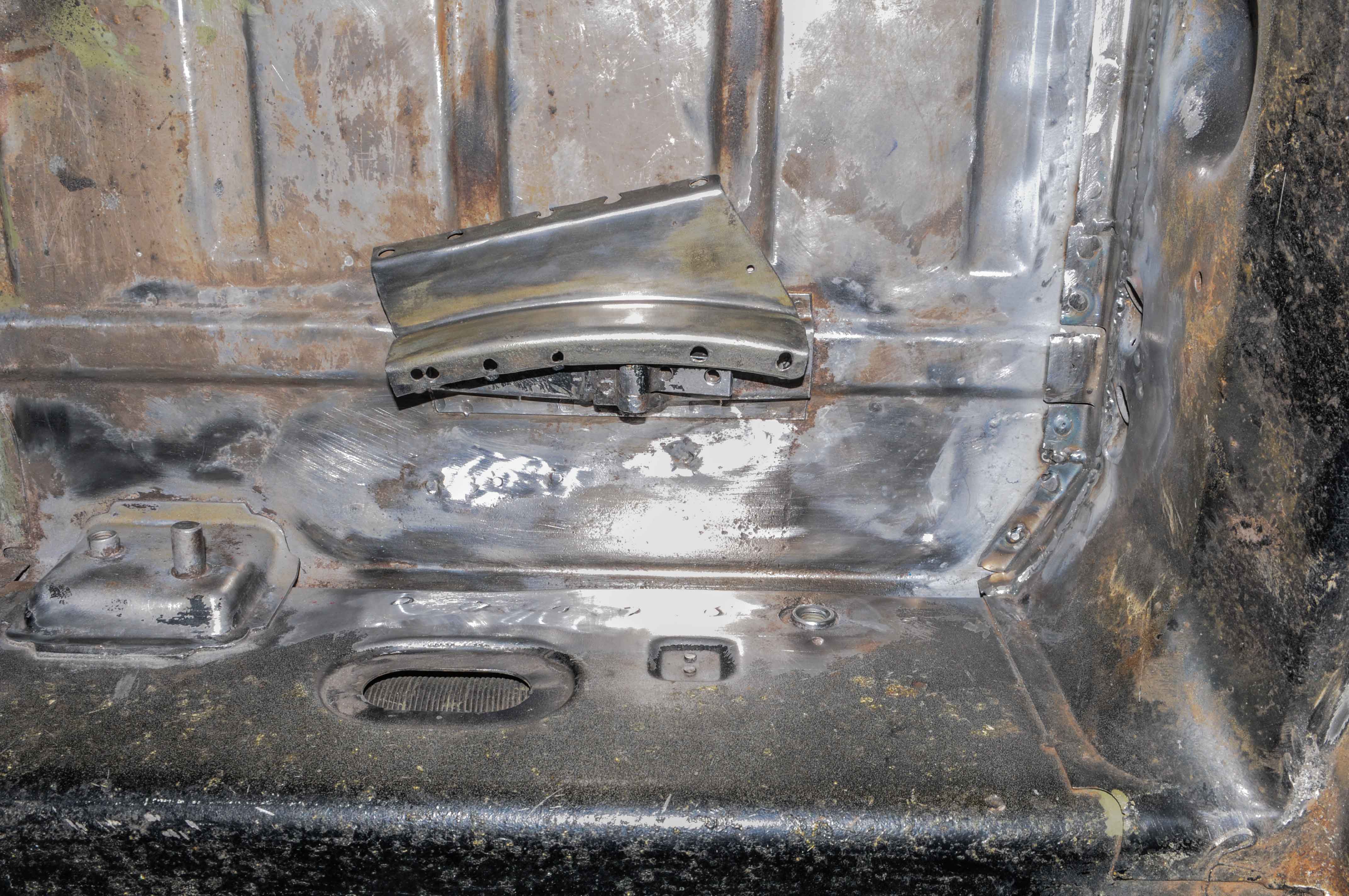

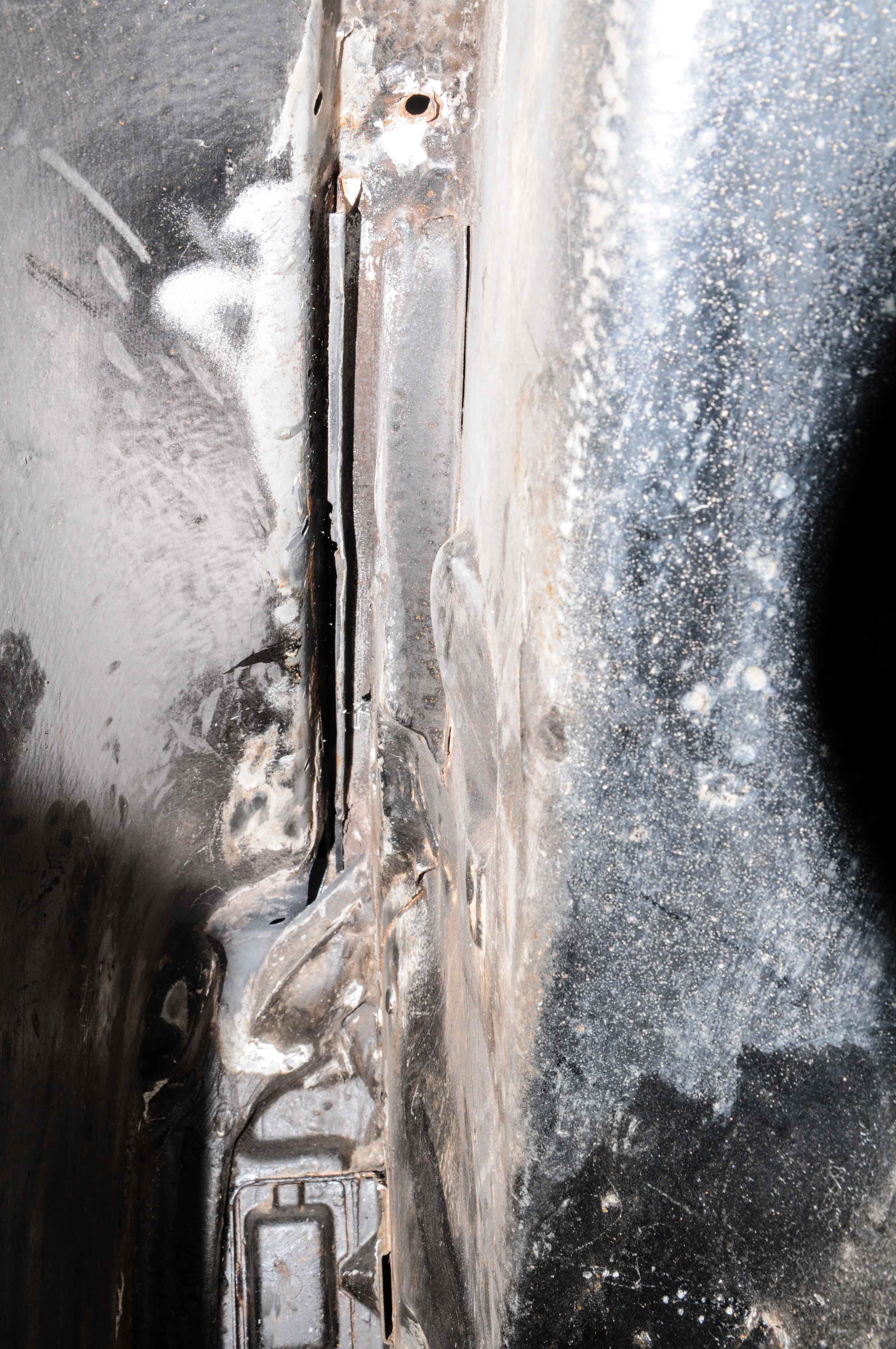

It was a good but painful day in the shop--this shoulder is killing me.
I started the day welding up the dimples and holes from when I drilled out the spotwelds on the parking brake cable guide. I then cleaned the area up some more and applied Rust Bullet where I won't be welding and not be able to get later; and after it dried I applied some weld-thru primer where I will weld. Tomorrow will be some seam sealer on the floor/long lip underneath the cable guide and maybe welding (I realized today that I am extremely low on welding gas so who knows).
While waiting for the paint I kept myself busy removing the foam and seam sealer from the rear corner (it looks good back in there!) And then started to remove the stuff up in the jamb/sail panel. This is where it killed my shoulder chipping it out. I couldn't quite get it all and my shoulder was throbbing so I thought about just quitting and leaving a bunch there, but I noticed some rust peaking out. I knew the only real option I had was to cut an exploratory hole in the sail--and I hit pay dirt (rust). I used the hole to get the seam sealer out of there and found that I also had to drill a hole on top of the fender to really get all of it out. The rust I found required the sail panel hole to be cut a little more but it allowed me to use the sand blaster to get the surface stuff that was left in there. I sanded the surface rust that dwelled where that long strip of foam was, and when I was satisfied with the results I osphoed the whole region.
The plan moving forward is to clean up the ospho residue, weld up the holes and trim holes, get some paint up in there and eventually seal up the seams. My lack of welding gas may delay the process, so tomorrow will be welding prep and maybe the removal of some other random car pieces or moving on to the frunk seal channel.
