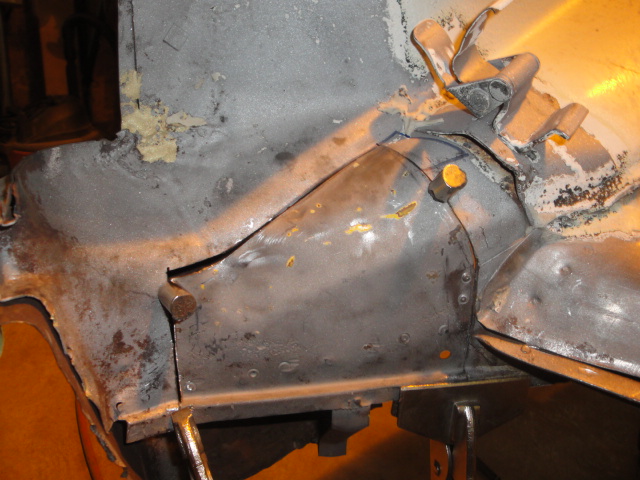

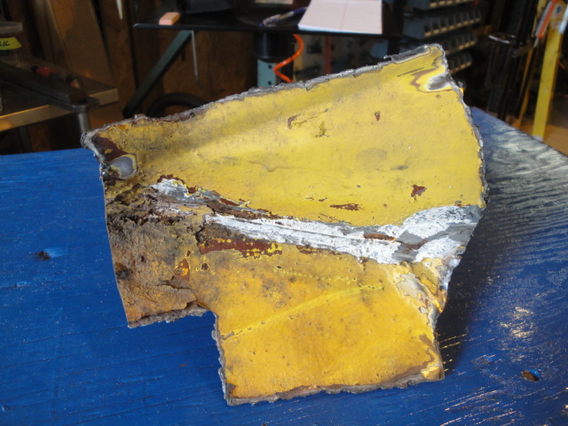

Here is the left inside trunk corner cut out from the parts car.

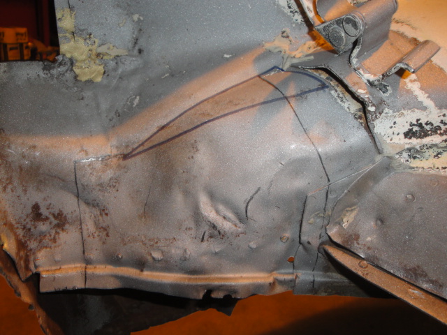

Here's the ugly, over hammered and bumpy section I'm cutting out.
After some measuring, trimming, fiddling and fitting. Its ready to weld in on Thursday.

cary   Here is the left inside trunk corner cut out from ...   Jul 24 2016, 06:29 PM

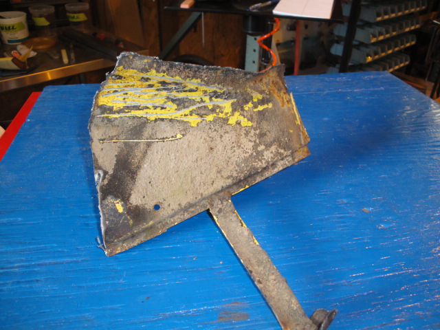

cary   As I was working on the inside of the trunk. Super...   Jul 24 2016, 06:37 PM
