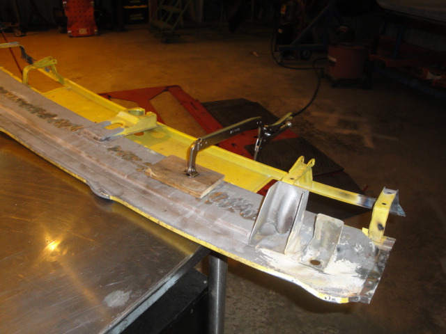

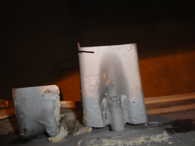

As I was working on the inside of the trunk. Super In Law went to work on repairing the butchered up tow hook framework.
He's building the extension rather than cutting up the other cut out tow hook.

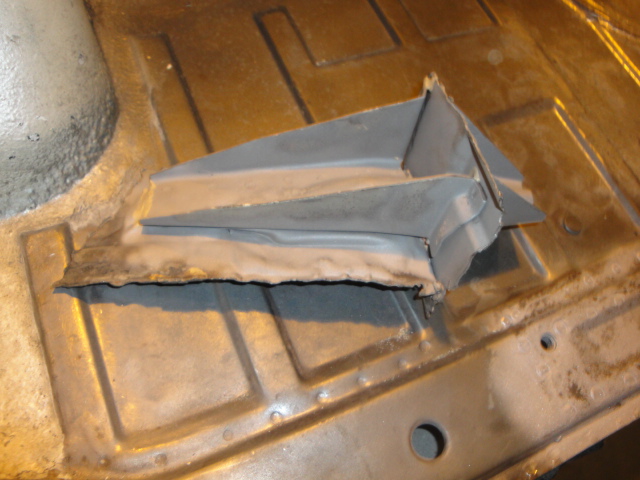

cary   Here is the left inside trunk corner cut out from ...   Jul 24 2016, 06:29 PM
cary   As I was working on the inside of the trunk. Super...   Jul 24 2016, 06:37 PM
