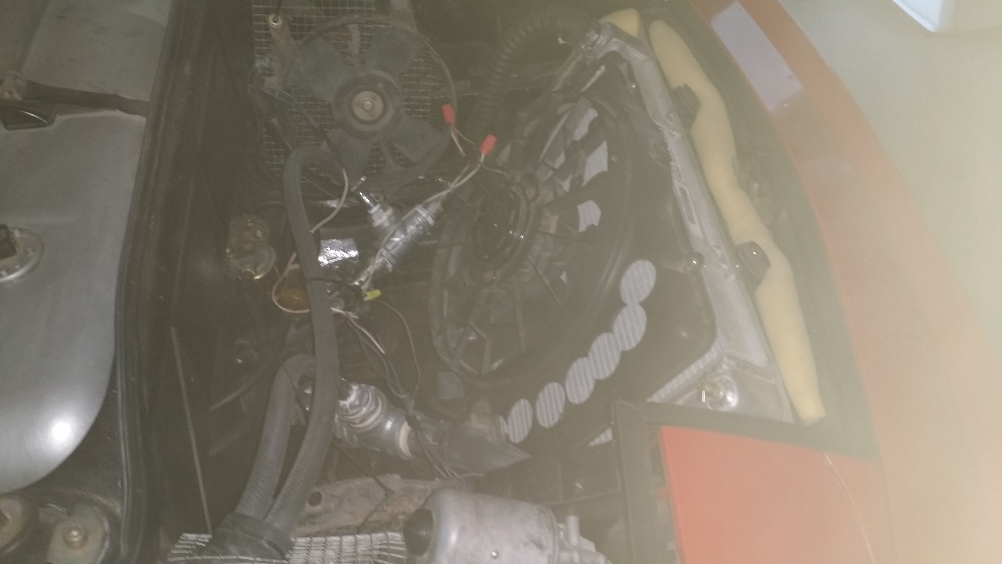

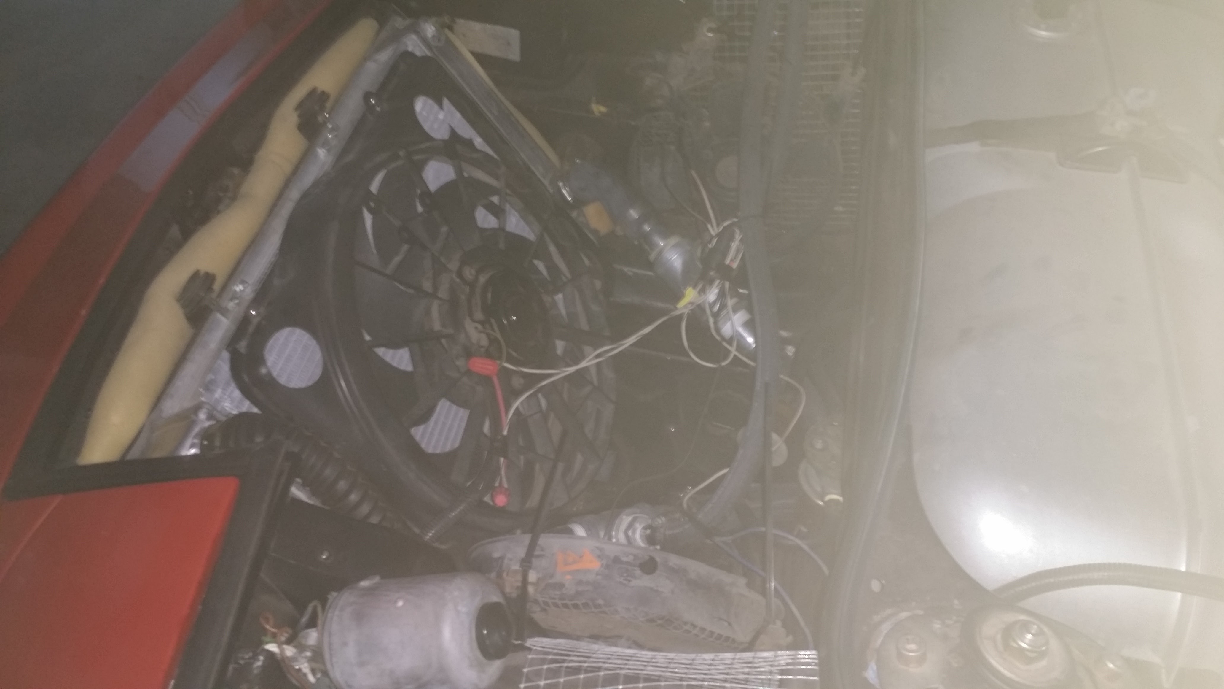

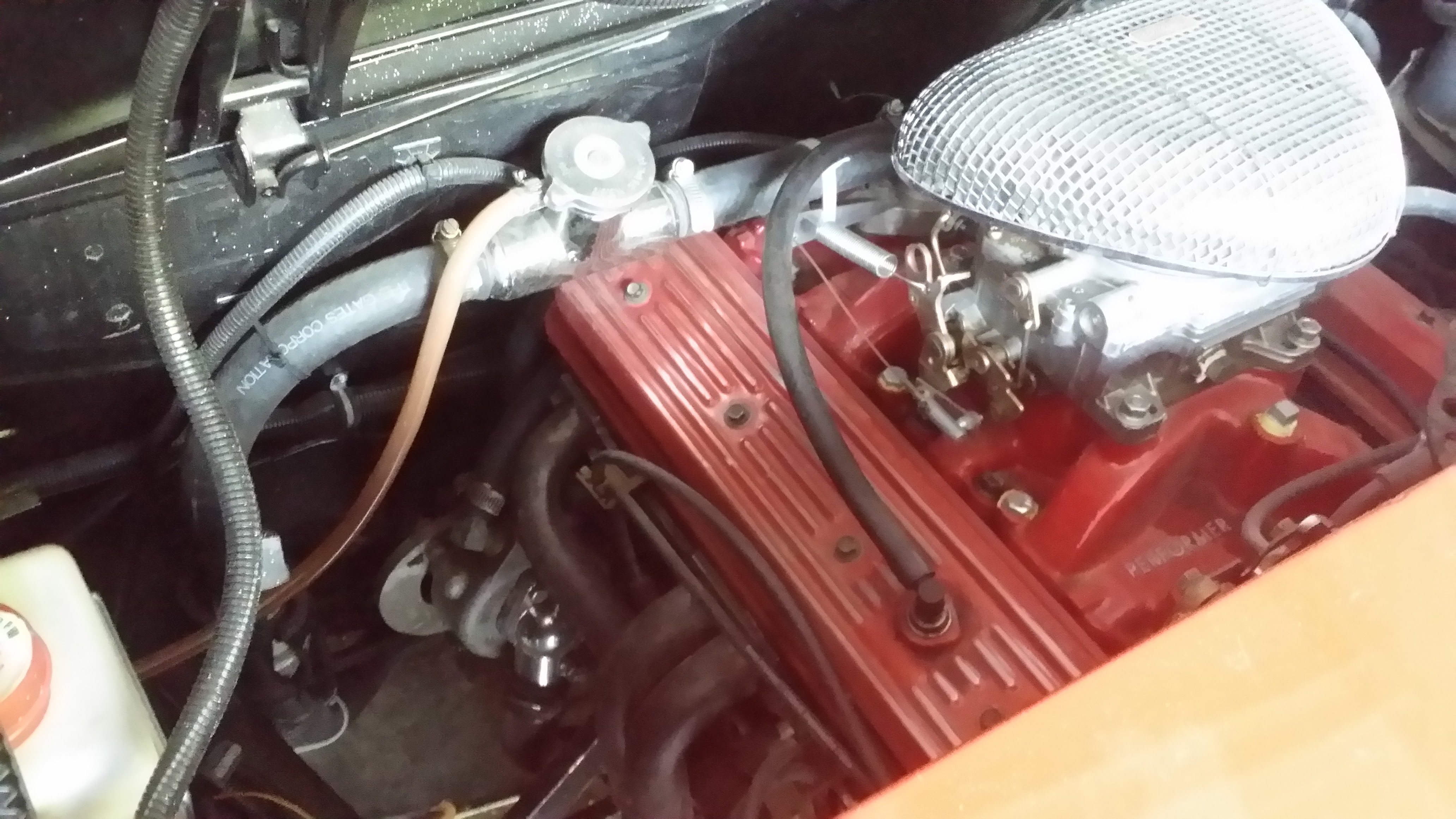

Here are some pictures I took today.
The holes in the shroud are new... as a test top see if it made a difference. I think it did because in the past (with no holey shroud), it did not matter how cold it was outside; the temp would always go to 200 and beyond (have a 160 t-stat with bleed holes drilled and the fan is set to turn on at 180). After cutting the holes in the shroud, the temp would stay at around 180 (acceptable) although it was when it was cooler outside. Now in this 100 degree weather... it does not matter... it still get to 200 and beyond).
The extra fans are from a Toyota 4-Runner AC condenser units and were mounted there temporarily to see if they made any difference in assisting the main fan exhaust air from the front area (they were wired to push air out). They did not work.
Also; my temp sensor is mounted in a port right next to the t-stat/intake manifold.
