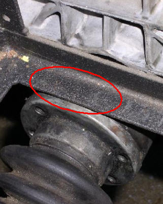

QUOTE(sgomes @ Oct 10 2004, 12:13 PM)
... So it looks like I'll have to move my battery boxes up.
Shannon,
Could you cut out a small section from the bottom of the battery box right above the CV joint to gain the clearance? That angle iron looks fairly thick. Or would there be a problem with the CV joint potentially rubbing on the bottom of the battery?
-Jeff

sgomes   One step forward and about 10 steps back.... :ang...   Oct 10 2004, 01:08 PM
sgomes   'nother view. That electric motor sticking ou...   Oct 10 2004, 01:10 PM
sgomes   ... and 10 steps back... The only thing differe...   Oct 10 2004, 01:13 PM
sgomes   Hmmm that's about 24 bolts (2 boxes), a bunch ...   Oct 10 2004, 01:17 PM
neo914-6   Can't you just space the tranny mount lower to...   Oct 10 2004, 02:02 PM
sgomes   That's a great idea for the long term. Thanks...   Oct 10 2004, 02:26 PM
Dr Evil   Will you still have a clutch? Will shifting be nor...   Oct 10 2004, 02:37 PM
sgomes   Yep, clutch is stock. Shifting is normal I just do...   Oct 10 2004, 02:48 PM
sgomes   Ok, so I've been laying under the car staring ...   Oct 10 2004, 04:05 PM
