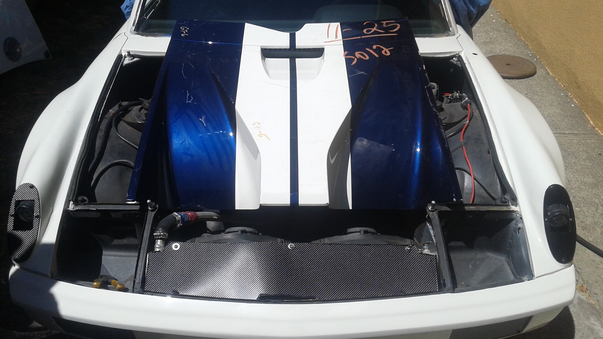

In the works as we speak because the wheel well exit is really inefficient and prehistoric. I'll send more pics when it's finished. The damn gas tank bar which ties the two shock towers together is our major obstacle at the moment, but making progress. (IMG:style_emoticons/default/mad.gif) Attached Image
