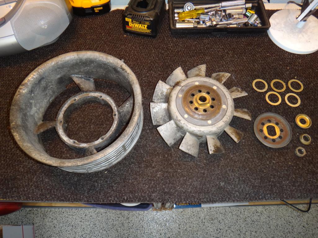

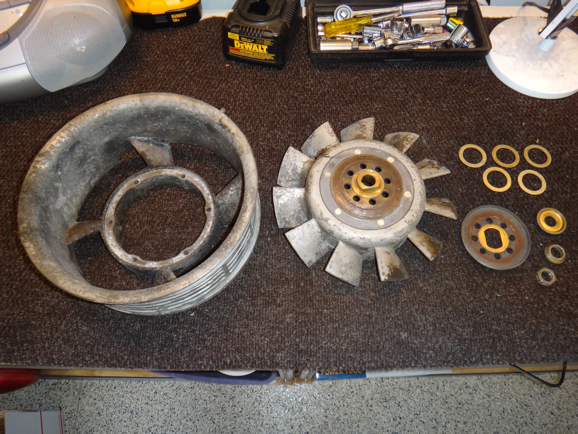

Some other back burner items getting finished while Cary works on the metal work.
The fan/shroud from the 2.4 MFI T motor.
Years of decay and corrosion.
Some nicks and chips in the blades.
Etc, etc.
Sent them out to Mark Motshagen for refurbishment.
The end result is quite stunning.
So.....
THE BEFORE:
