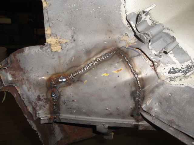

Welded in the left inside trunk corner. Fit real nice.
I added back in/on the tail of the inner fender portion.

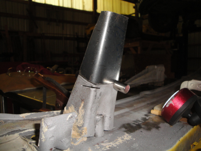

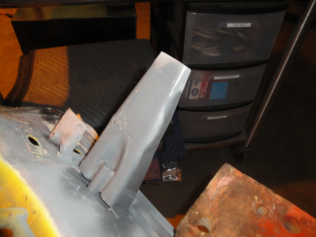

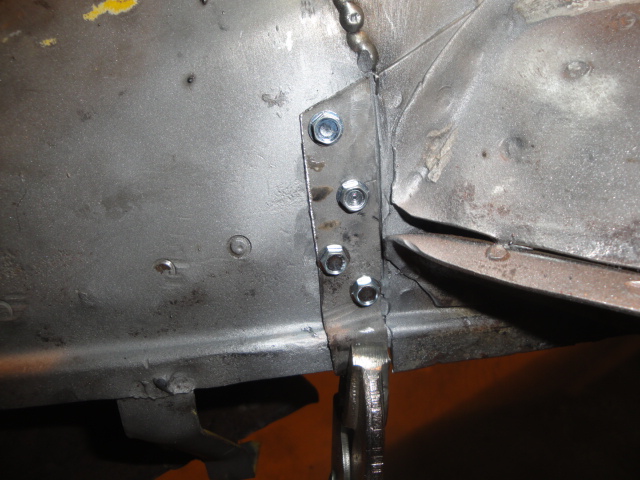

Then I welded on the tow hook extension that Super In Law created on Friday.
