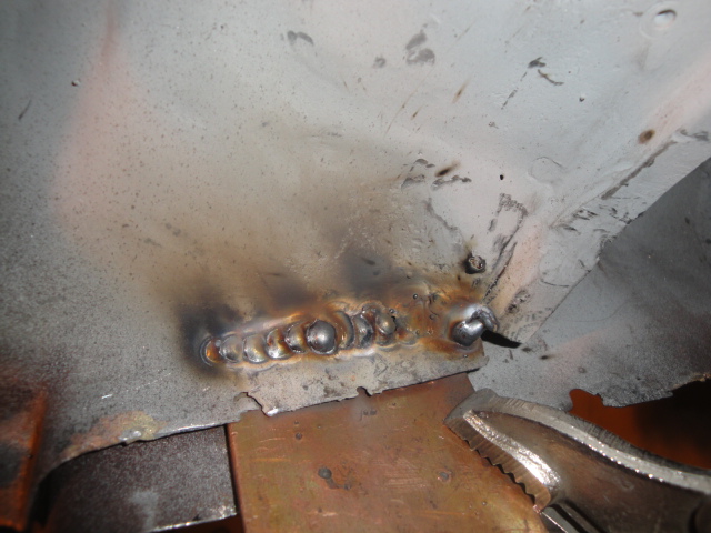

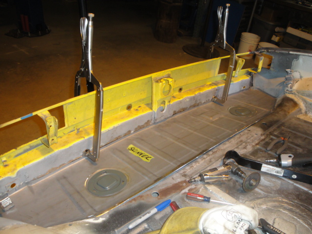

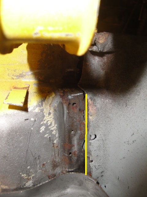

Then went after trimming down the trunk panel somemore. Reinstalled the taillight panel to check all the edges. I won't install the taillight panel until we change out the back end of the qtr. panels. Don't want to get the cart ahead of the horse ...............
After fitting the trunk panel I decided I'll do a complete extension of corners. The panel is just a bit short in the corners. More to come tomorrow..........

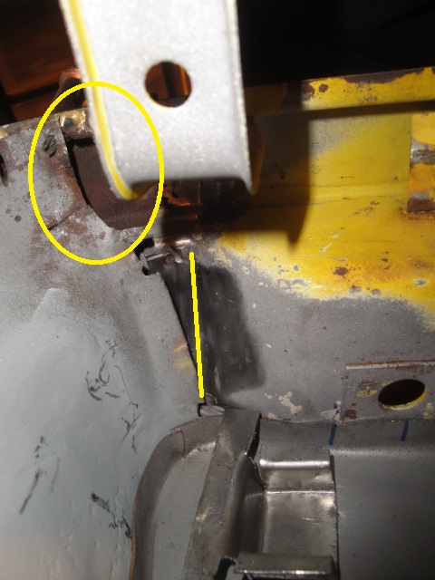

Then onto the inside tie in portion of the tub that welds to the taillight panel. Doug's was squished and over hammered. The ones off the parts car were rotten.

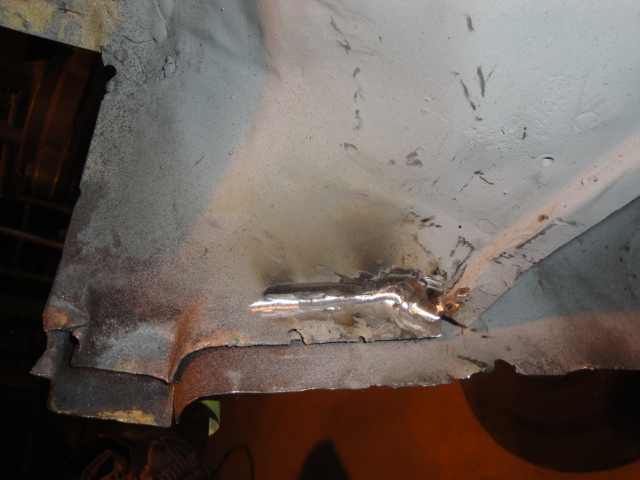

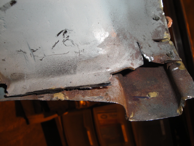

Left side ................... Buckle needed to be cut open and the edge straighten.
Right side ............... pretty messed up.

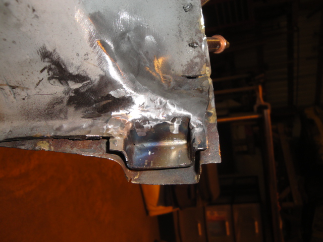

Left side all tidied up with my electric glue gun.
Sorry for the sideways .....................
Then onto the right side repair. Super In Law created the patch piece last Friday.
