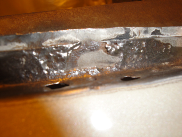

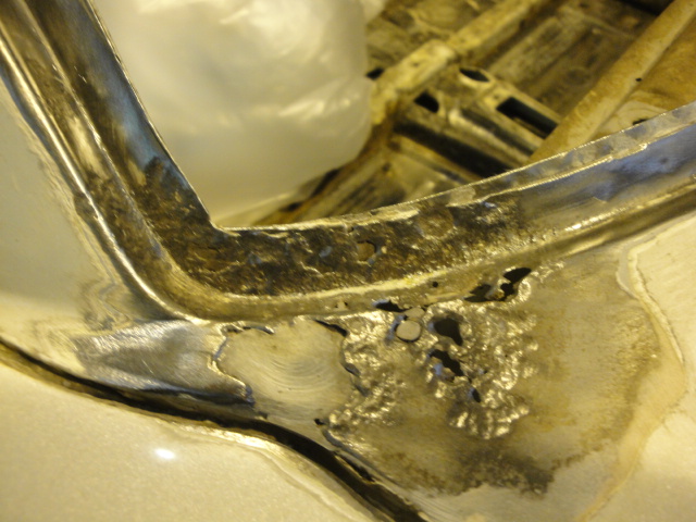

cary   Here is the left inside trunk corner cut out from ...   Jul 24 2016, 06:29 PM
cary   As I was working on the inside of the trunk. Super...   Jul 24 2016, 06:37 PM
