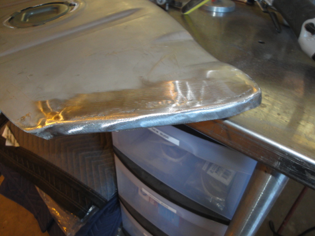

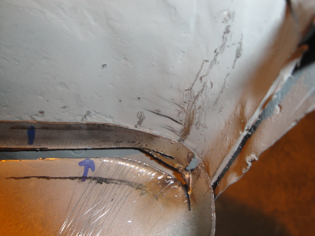

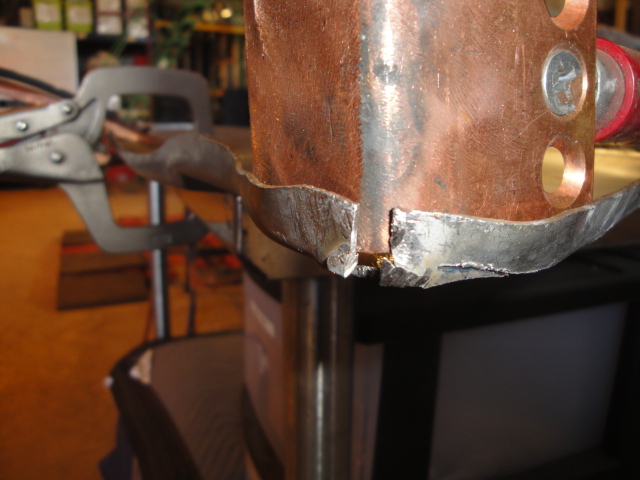

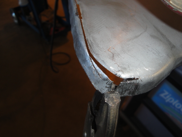

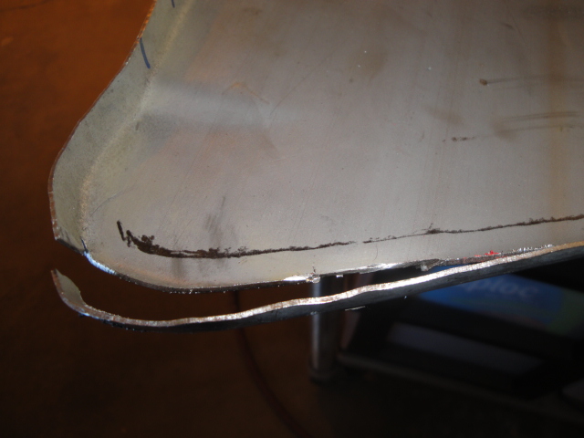

Began with cutting the right corner of the trunk panel to create the extension needed to fill out the corner.
Basically cut it right in front of the vertical flange. This will allow me to swing the vertical portion out to the wall were it needs to be.
This is the extension needed to get the correct fit.

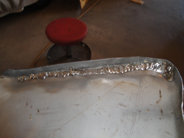

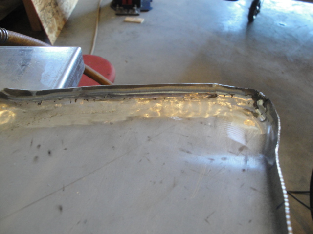

I use numerous shapes and sizes of brass backers to assist in welding in the large gaps/areas.
Here is the finished work. Before and after grinding.
You don't need to get too carried away with grinding. Most of the new extension will be covered with seam sealer.
