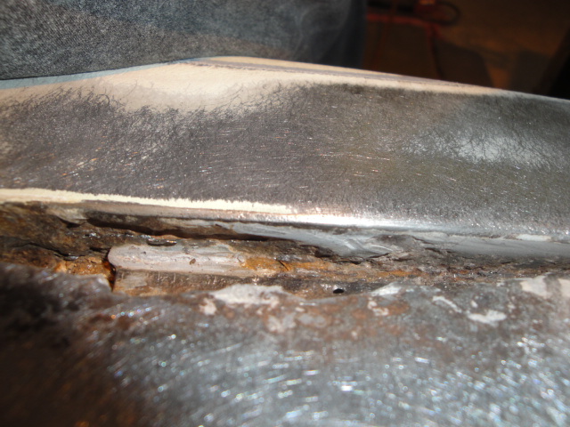

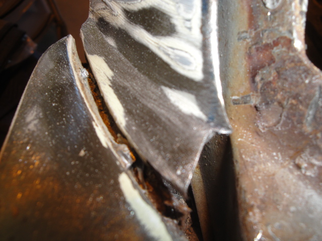

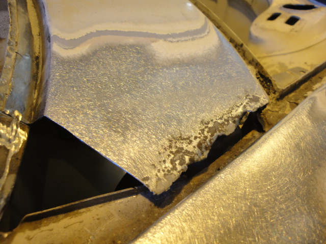

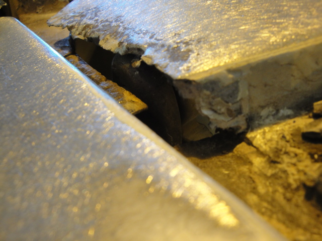

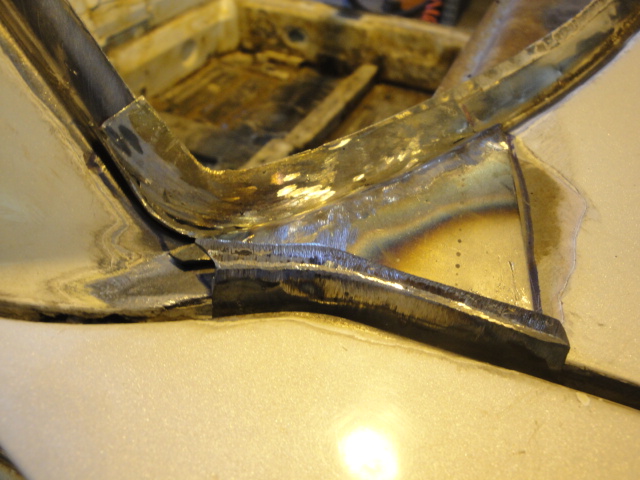

While I was expanding the trunk floor Super In Law was cutting some pieces for the right window cowl.
He created what we thought we would need.
But after I cut open the top portion all I found was Bondo. (IMG:style_emoticons/default/sad.gif)
These are shots after Bondo was dug out.
Talked to Doug at PIR before I posted the pictures. Not exactlty what we thought we'd be looking at. He'll get a windshield cowl coming from DC.
A couple more shots. I'm hoping with the new cowl I can save us from removing the fender.
