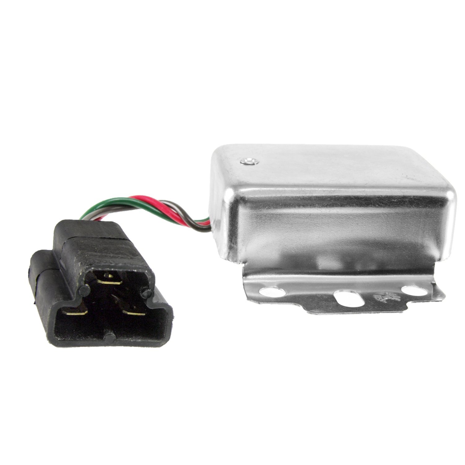

just checking around to purchase a VR, if needed.
What is the deal with the BOSCH unit. $250? the other brands look much different but cost between $20 to $50
Which one are the masses buying for a Daily Driver?
New Bosch (shorter, but similar)
amazon calls it "external", AC / Delco brand I think $30-ish
BERU brand from Germany for $21
