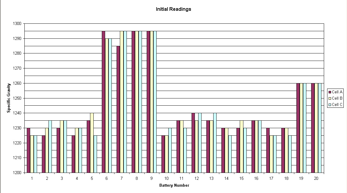

I'm borrowing this space so that people on the EVDL can see the data.
