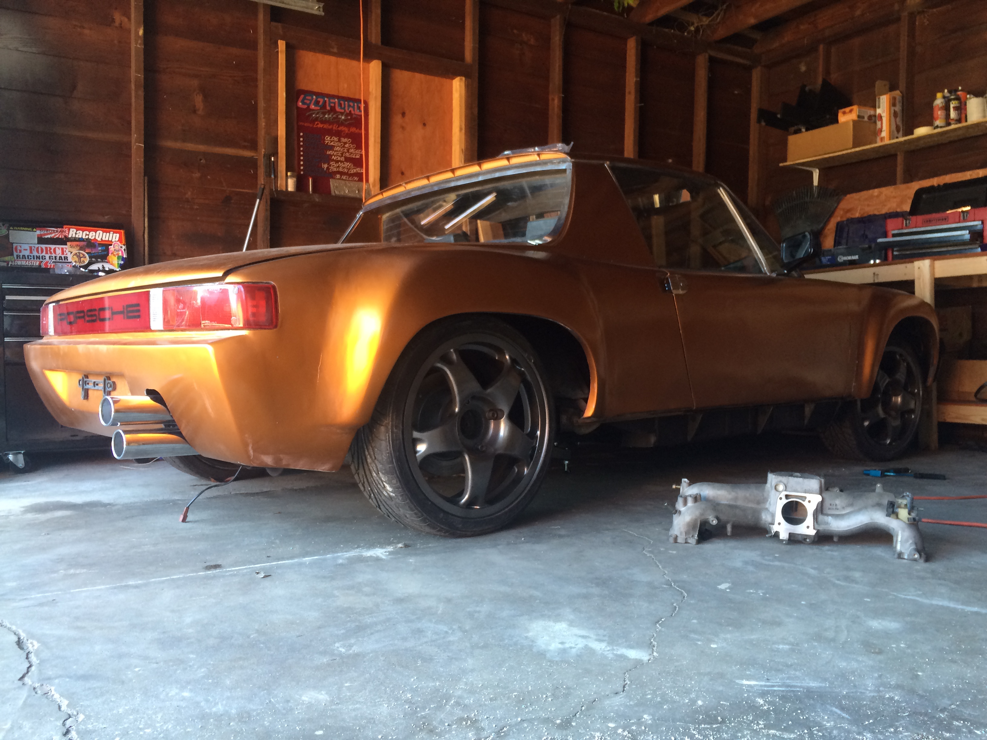

so ive finally got my special exhaust done and its friggin cool. 110$ at austins pro max in tacoma. However tradgity struck while i was towing it, the front oassenger wheel came off but the only damage done was to the inner rim and it tore 3/4 of the flare off (IMG:style_emoticons/default/dry.gif) nothing rivits couldnt fix though, all involved were ok! back to the good stuff though the exhaust is about 2.5' long, leaving me with the certainty my neighbors will hate me more than they already do considering my other car is a straight piped bug but oh well I await their 911 calls (IMG:style_emoticons/default/driving.gif)Attached Image
