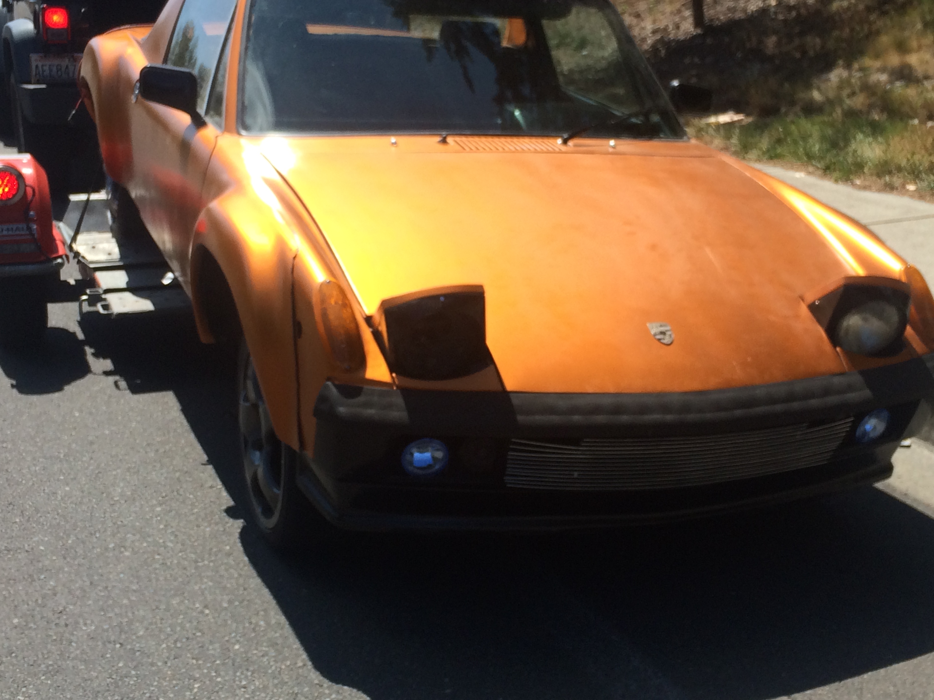

Hello ive thought about doing this for a while but lately ive had an itch and lots of questions and little want to open 1000s of threads so here it is. Subydoo i bought a 1970 914 from a one legged guy in my home town who bought it from a crip in a neighboring city. straight off the bat i knew i was gonna ej turbo swap it.Attached Image

This was the damage from the wheel falling offAttached Image

tazz9924   This was the damage from the wheel falling off   Aug 5 2016, 10:28 PM
