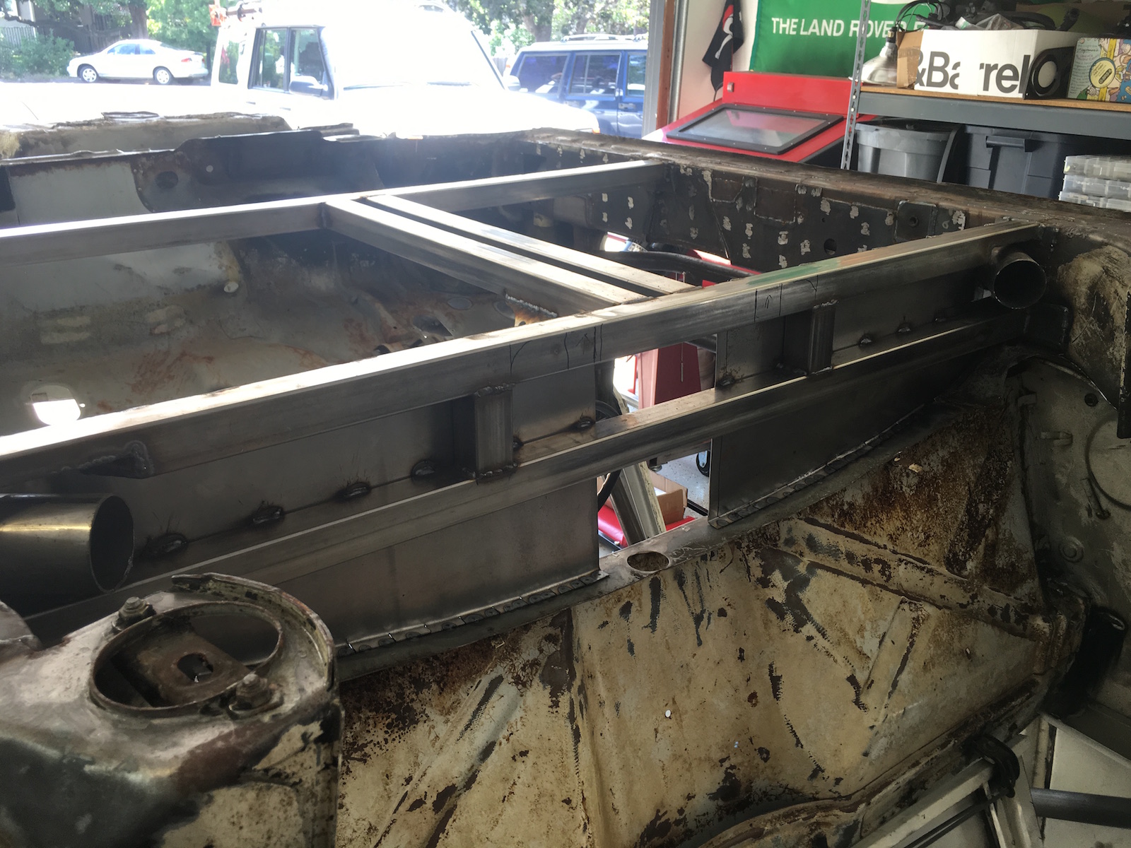

Today, most of the chassis kit is installed but I can't finish it until the roll-cage is put in. Tangerine is almost done with the cage so it'll be another week or so until I see it.

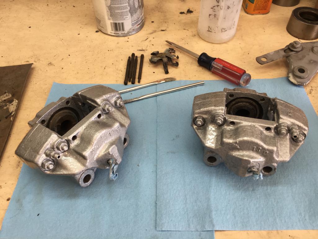

• Rebuilt a set of Carrera rear calipers to use instead of 914 calipers which will allow me to use vented disks in the rear.

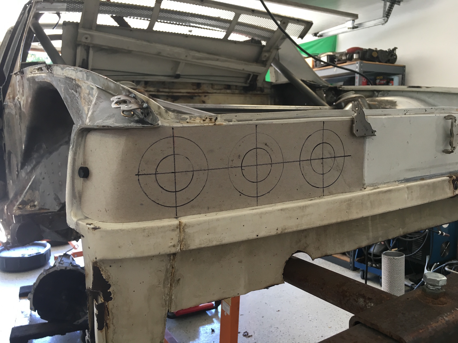

• Started mock-up of the lightweight custom LED (cheap) tail lights Im building

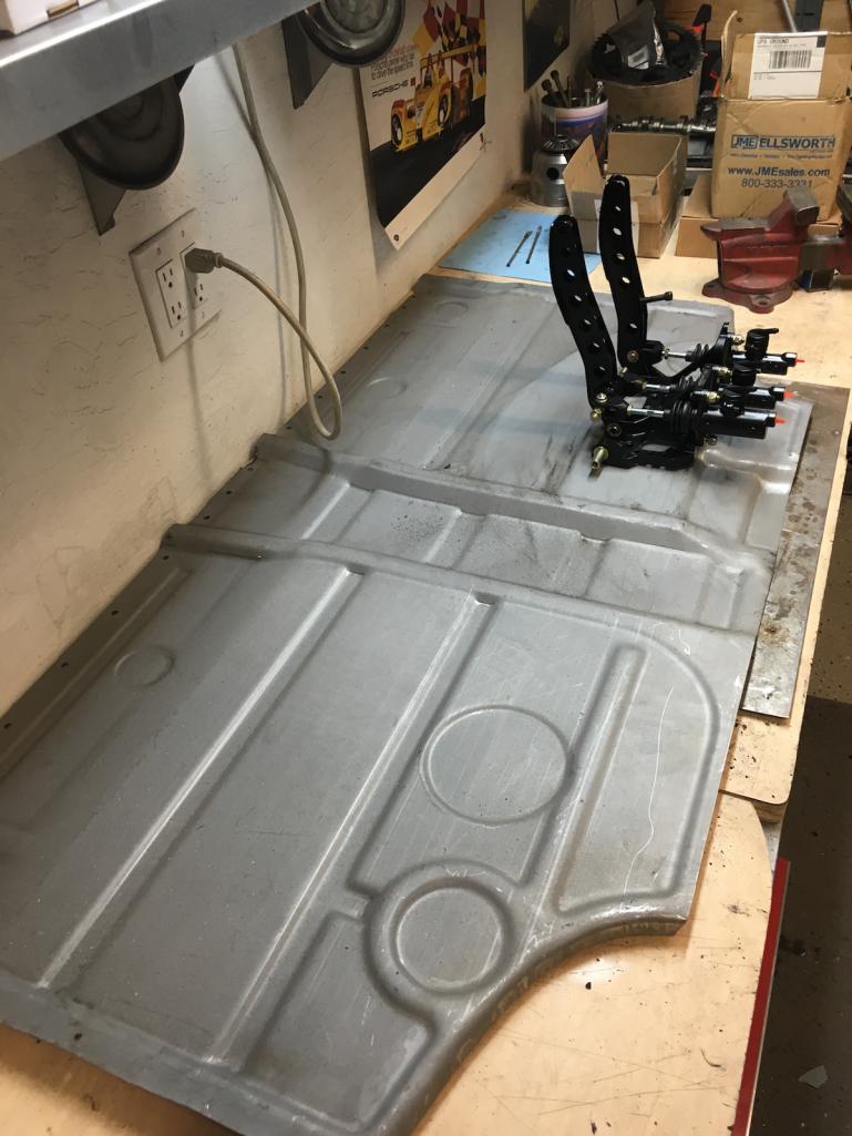

• Bought Wilwood pedals, MCs, and bias adjuster. Now I can start fab / install of the front pan section

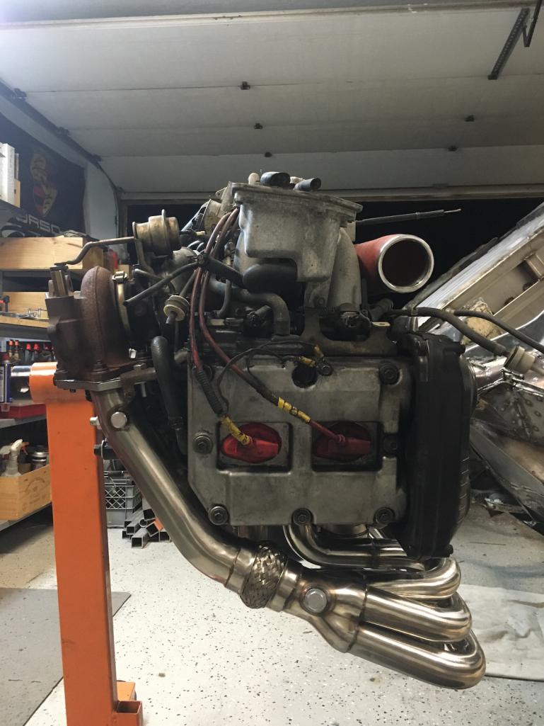

• Put a new header and oil pan on the WRX engine. The old header was rusty and the pan had a crack.

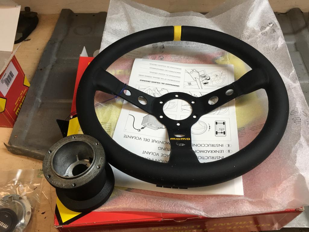

• Bought a new Momo wheel and hub. Looks so good in the car, loving it.

• Fab a plate to mount the pedals to the floorpan

MichiganMat   Bought the motor and trans this past week. EJ205T...   Jan 31 2016, 12:33 PM

MichiganMat   Had a couple of good nights of work lately: - Tied...   Feb 27 2016, 06:42 PM
