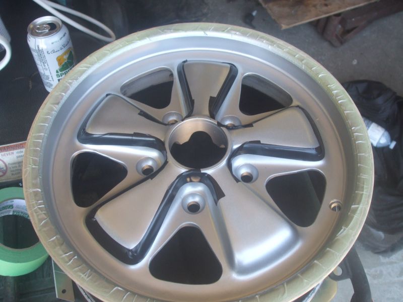

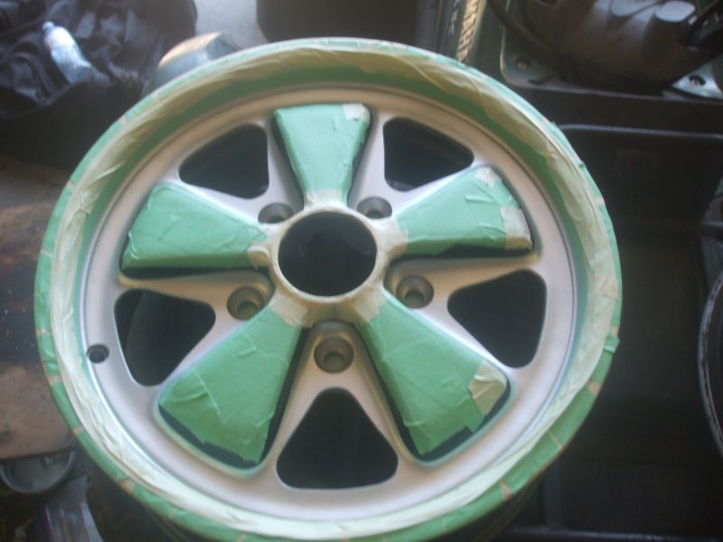

But I have new motivation to get my car back on the road so I had to finish these off.
I was going to clear anodize the rims but I have to much on the go to make the tank.
So I did the whole face in in Rustoleum brilliant silver metallic and then the relief in satin black, the lips I polished.
I used electrical tape to do the edges, works good but leaves a residue that you have to carefully clean off.

Mark Henry   I did it all by eye, not 100% perfect, but they lo...   Aug 10 2016, 11:45 AM
