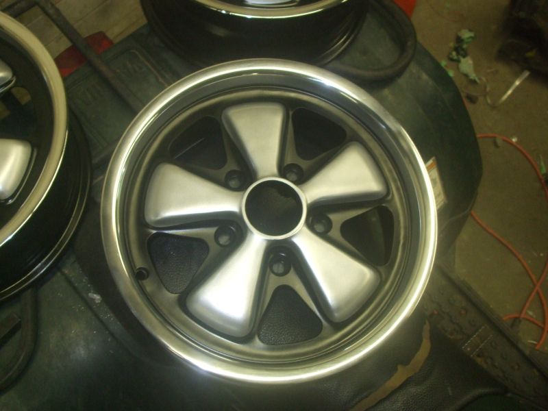

So I'm doing the RSR treatment to my straight but cosmetically challenged Fuchs.
First I stripped the anodising from one wheel using a caustic soda (also known as lye or Sodium hydroxide) solution, it takes off the anodizing like a champ, but hardly touches the old paint. Bottom left rim first pic has been in the caustic soda . So it was off to the hardware store for some stripper. The stripper worked, but I had to take off the paint leftovers with the bead blaster (last pic). They are going back into the caustic soda solution again tonight to get rid of the rest of the anodizing. I love the finish, it has me debating whether to leave them like this or to paint the usual black background. (IMG:style_emoticons/default/idea.gif) Attached thumbnail(s) |

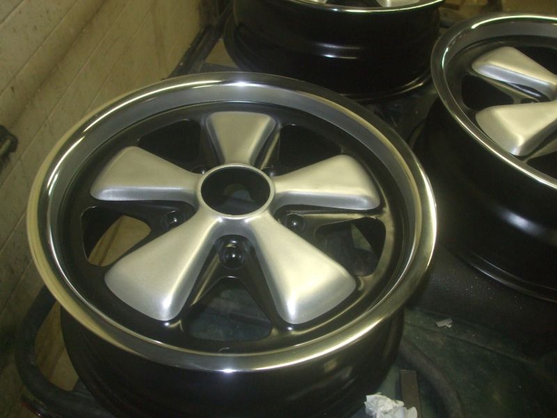

I did it all by eye, not 100% perfect, but they look damn fine to me
Now I'm debating if I should clear coat the whole face. (IMG:style_emoticons/default/idea.gif) Attached image(s)
