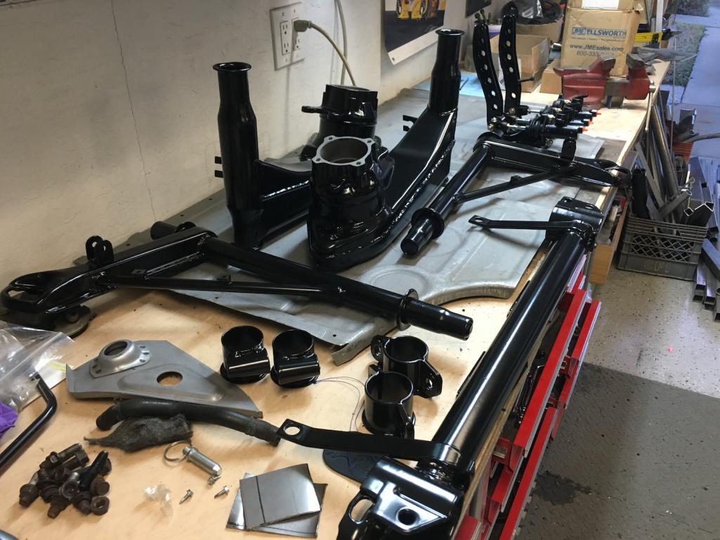

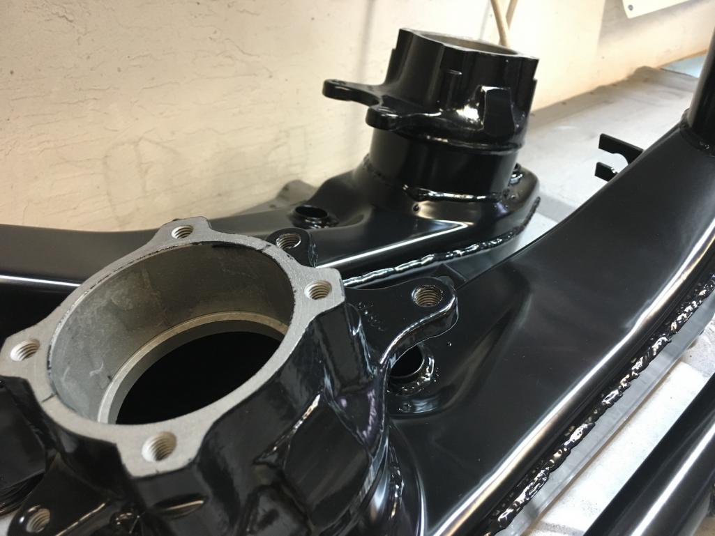

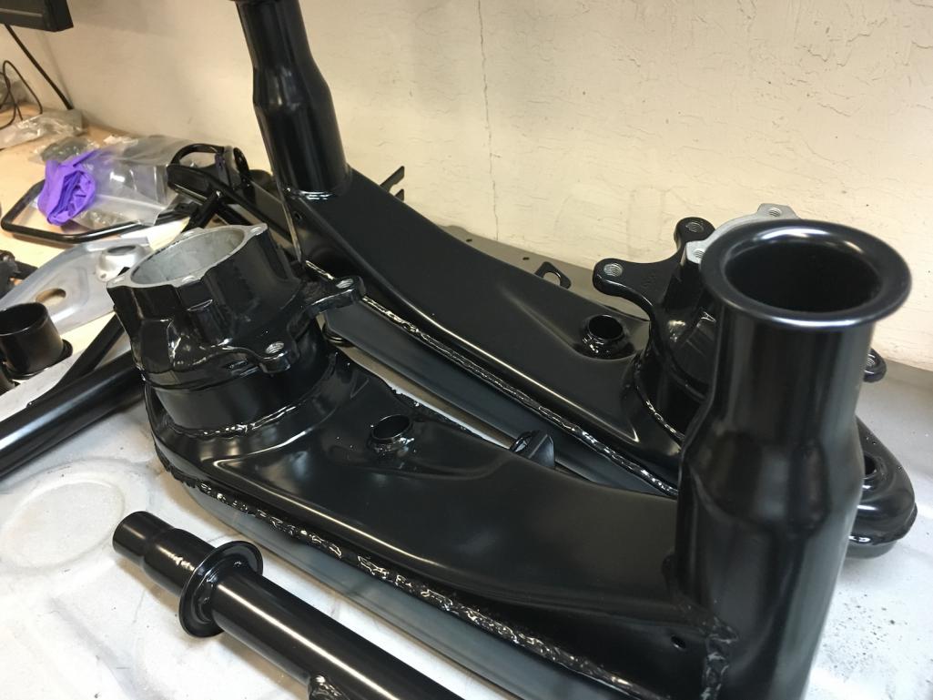

Picked the suspension pieces from the powder-coater yesterday too, super happy with the results:

MichiganMat   Picked the suspension pieces from the powder-coate...   Aug 11 2016, 08:21 AM
