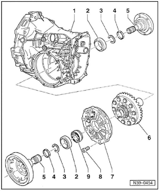

fiid   What does the audi gearbox output shaft flange loo...   Oct 12 2004, 10:31 AM
914_1.8t     Oct 12 2004, 01:41 PM

914_1.8t   Audi Trans:   Oct 13 2004, 12:57 PM
