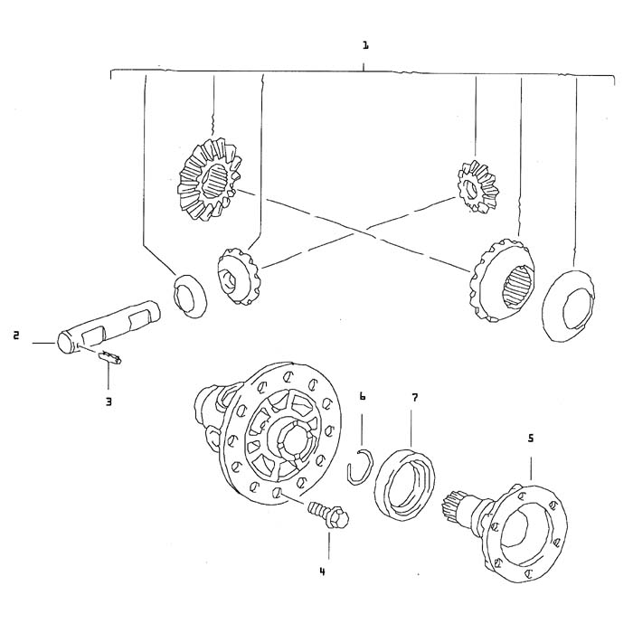

neo914-6   I just realized I may have 911 axles when I purcha...   Oct 11 2004, 12:48 AM
James Adams   Check out these axles. Many different lengths (15...   Oct 11 2004, 06:05 AM
914_1.8t
  Oct 12 2004, 12:44 AM
neo914-6   The axle overall length is 23 1/2" The outer CV fa...   Oct 12 2004, 12:57 AM
neo914-6   Axle end..   Oct 12 2004, 01:01 AM
neo914-6   CV end...   Oct 12 2004, 01:02 AM
fiid   What does the audi gearbox output shaft flange loo...   Oct 12 2004, 10:31 AM

fiid   This looks totally do-able. The 911 driveshafts a...   Oct 13 2004, 12:50 PM

neo914-6   Sonu, Your Audi output flanges must be 108mm to f...   Jun 4 2005, 01:10 PM
