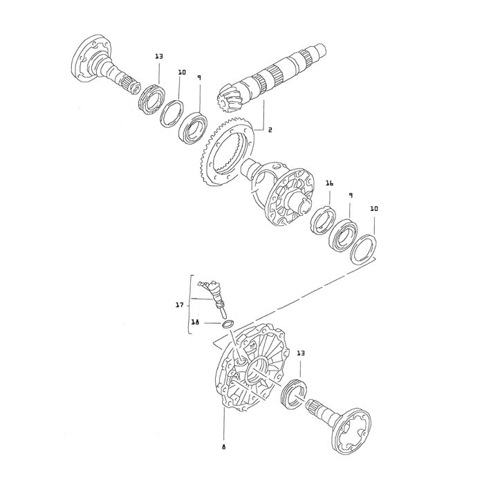

fiid   What does the audi gearbox output shaft flange loo...   Oct 12 2004, 10:31 AM

fiid   This looks totally do-able. The 911 driveshafts a...   Oct 13 2004, 12:50 PM

neo914-6   Sonu, Your Audi output flanges must be 108mm to f...   Jun 4 2005, 01:10 PM
