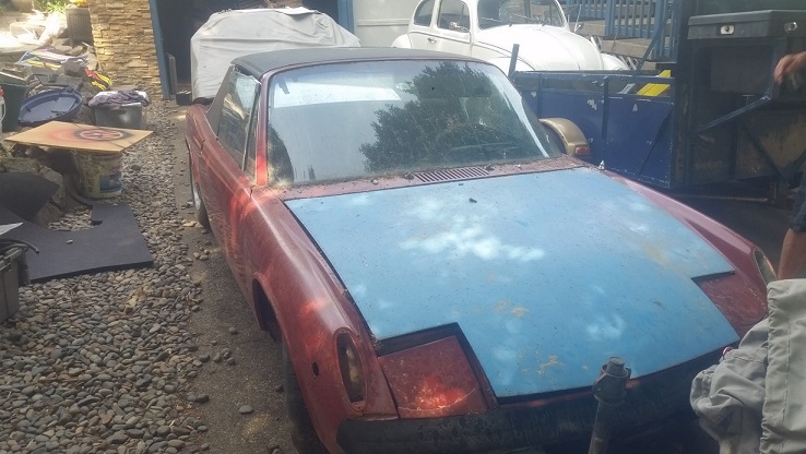

Looks like Doug's rear qtr. panel sections and windshield cowl will be coming off a donor car I'll be picking up on Thursday morning. I didn't look at the other sections too closely because I was focused on what I need. But both longs look pretty good.
I'm not one to cut into tubs that could be restored. But his car has been hacked up for some sort of V6 conversion.
California car that has only been up here in Portland a couple years. No rust bubbles in the sail panels either.
