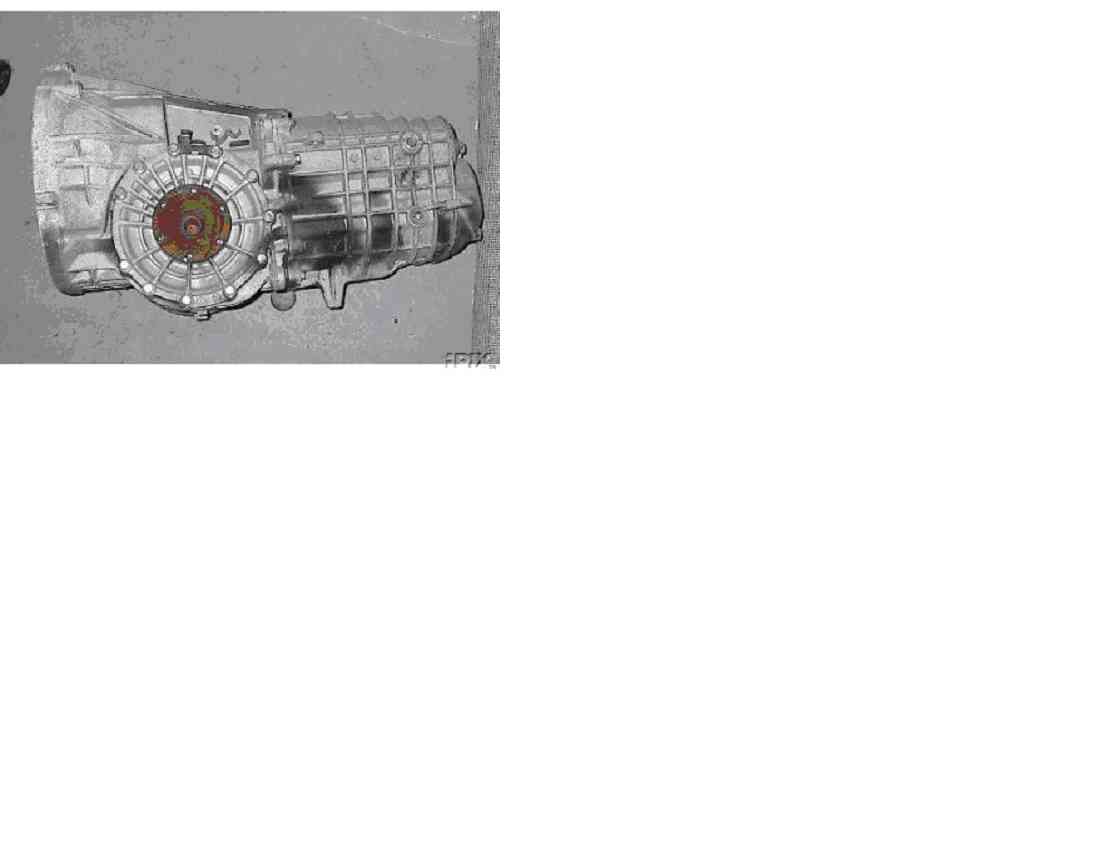

QUOTE(914_1.8t @ Oct 13 2004, 10:57 AM)
They have 6spd quattro tansmissions...infact the pic is of 6spd.
I believe you can use just the 2wheels via axles and leave the back disconnected.
Ok...another option (maybe).
I have heard that the early boxster trans is identical to the audi fwd 5spd trans, wonder if I can switch part number 5 for the following two diagrams. I belive the boxter trans is 108mm and would bolt 911 axles/CV's. Can anyone verify this.
I wonder how I can find out the number of plines for #5's of both the below?
The Quattro 6 speed has a hollow secondary shaft that the pinion shaft runs through. Wouldn't recommend it for high HP applications, but in your case it's probably not an issue. They are coupled together by a Thorsen for front to rear bias. There have been some that have considered locking the two shafts together to get a front drive only output, but the idea was shelved (can't recall exactly why).
Here's a pic of the boxster transaxle:

fiid   What does the audi gearbox output shaft flange loo...   Oct 12 2004, 10:31 AM
914_1.8t     Oct 12 2004, 01:41 PM
914_1.8t   ...   Oct 13 2004, 11:21 AM
914_1.8t     Oct 13 2004, 12:11 PM
fiid   This looks totally do-able. The 911 driveshafts a...   Oct 13 2004, 12:50 PM
914_1.8t     Oct 13 2004, 12:57 PM
914_1.8t   Audi Trans:   Oct 13 2004, 12:57 PM
914_1.8t   Boster trans:   Oct 13 2004, 12:58 PM
914_1.8t   Another of boxster trans:   Oct 13 2004, 01:31 PM
914_1.8t   try again: By the way, does anyone have a pic of ...   Oct 13 2004, 01:32 PM
fiid   A quattro tranny would work if you freeze (weld?) ...   Oct 13 2004, 01:37 PM
