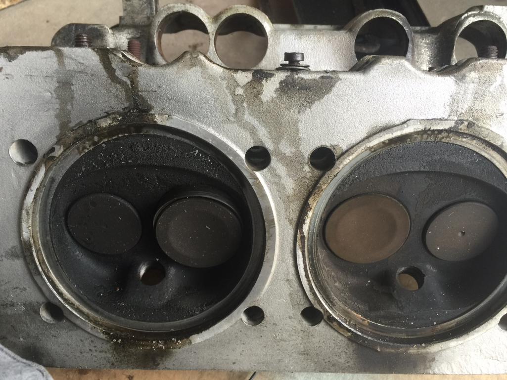

Way back in August 2013 I went to start my 914 and heard a funky noise. I immediately shut it down. Using my limited mechanical knowledge (and a tremendous amount of luck) I postulated that I had dropped a valve seat.
Three years later I decide it's time to get this 914 back on the road. Pulled the heads and, sure enough, a dropped valve seat. Prior to the issue the car was running good...no smoking, seemingly good oil pressure, etc.
I'm hoping I can get by with just rebuilding the head (if possible). Anyone see anything that would cause me to deviate from this plan of action?

The seat drop repair alone is not so bad, as far as consequences to the casting's integrity. But the crack out the exhaust port is a real killer for the T4. It can be repaired, (done it countless times over the past 20 years) but the casting will never be the same.
Time to stick a fork in that one.
BTW, those cracks were really common on smog heads. Is your head one of them? Just curious.

It's from a '74 2.0. I don't know if the heads are original or not.
