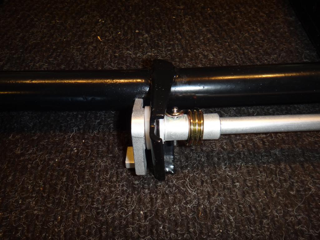

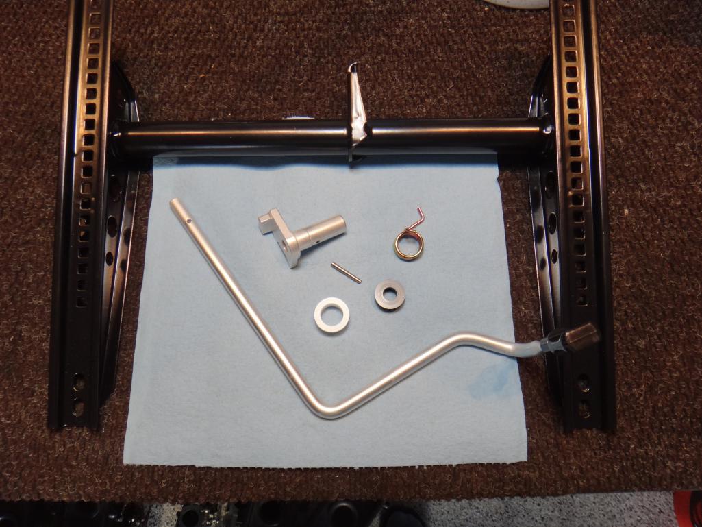

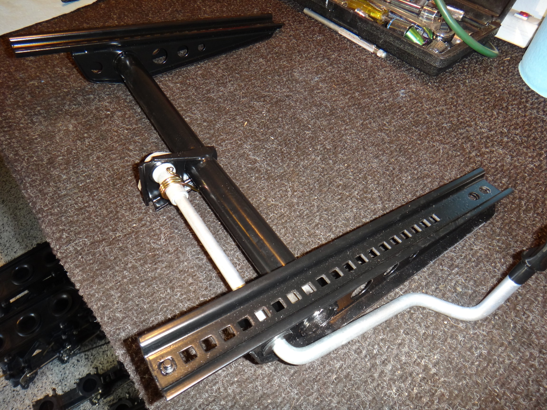

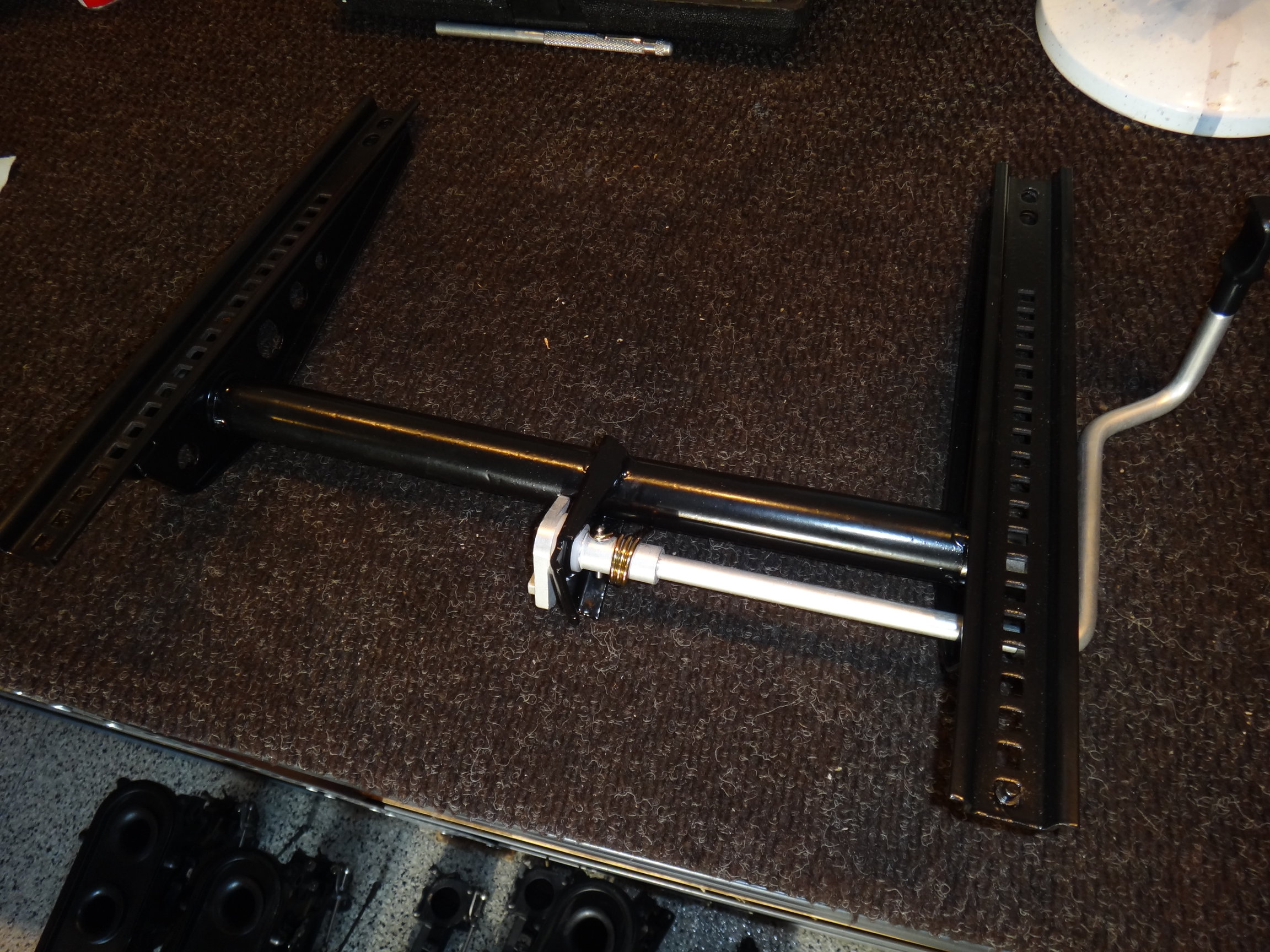

Just put together one of the seat bases after getting everything back from the powder coater and plater...plus using 914 Rubber's seat base bushing kit.
Everything went smooth excepting the supplied roll pin...just too large to fit in the hole.
So instead I used a tapered pin I found at our local hardware store.
Easier fit by far, and will never come out.
The big problem or puzzle was how to "wind up" the spring so that the tapered pin could be inserted.
Took some "Neanderthal" ingenuity, but I got it done with some help from the wife (need 3 hands for sure).
One more subsystem checked off.
