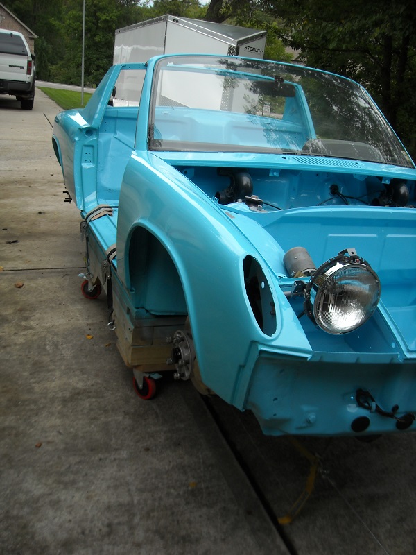

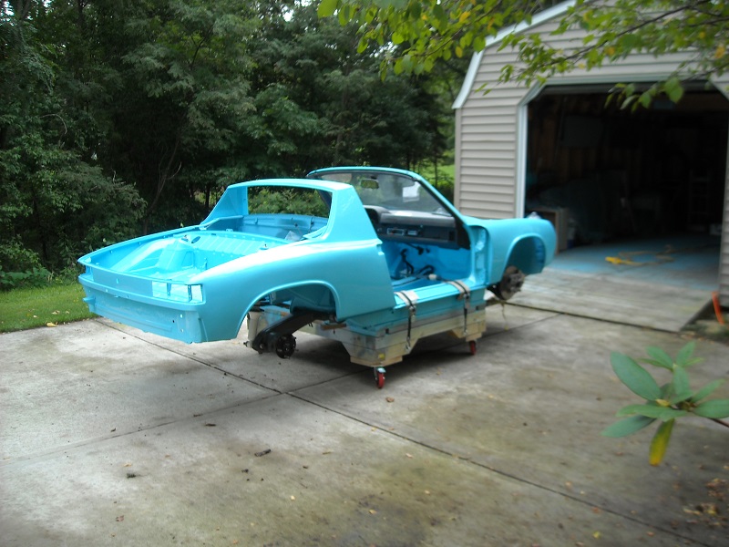

Moved it outside for some pictures. paint turned out good. still will need a cut and buff.
And starting to put stuff back on... (IMG:style_emoticons/default/piratenanner.gif)

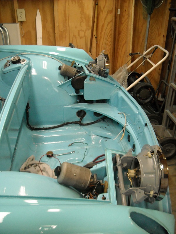

Refinished the headlight mechanisms and got them installed. Had to hunt down some little parts, Thanks for friends with parts cars... I need to get one of those..

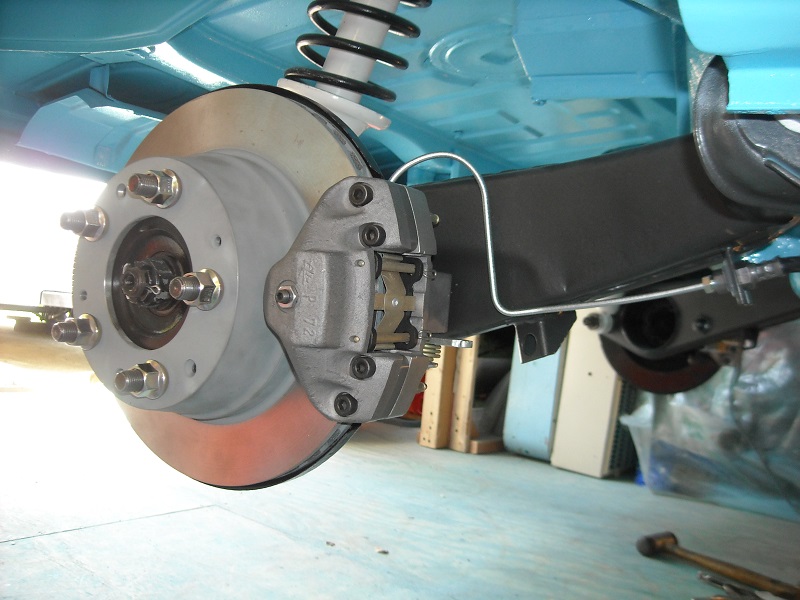

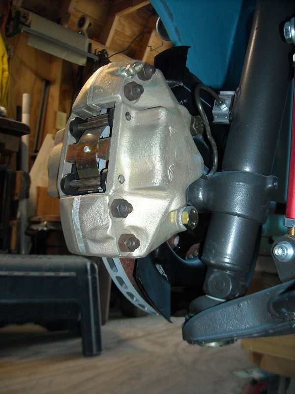

Installed the PMB 914/6 GT rear calipers and the vented rotors. also got all the hydraulic lines and hoses installed , glad I kept the old lines to use as a pattern. still need a couple little parts for the parking brake
those rear calipers should play nice with the with the A calipers and vented rotors on the front.
PMB also rebuilt my pressure regulator... Thanks Eric..

rgalla9146   Are they aluminum alloy rear calipers ?   Aug 27 2016, 12:08 PM
Olympic 1.7   Are they aluminum alloy rear calipers ? Yes, Al...   Aug 28 2016, 06:19 PM
