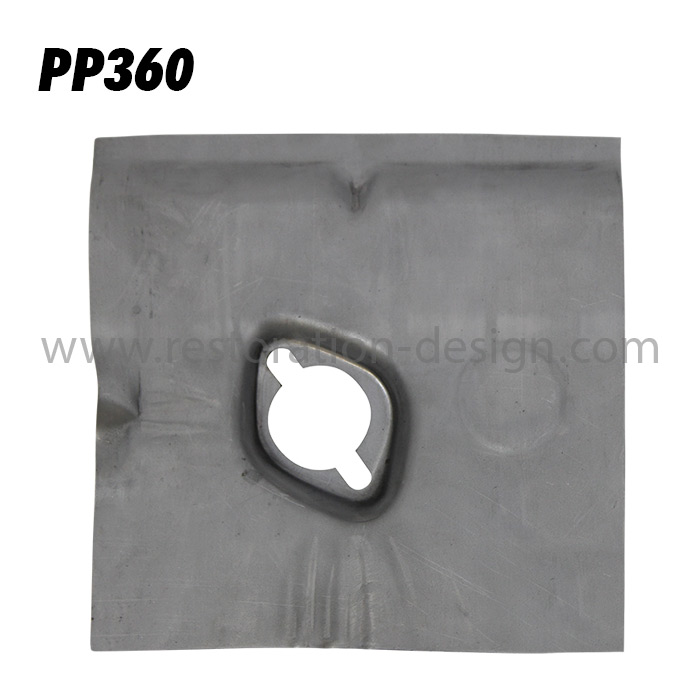

Update: Restoration Design sells the dash plate, see:
http://www.restoration-design.com/store/product/PP360

sixaddict   Does it make any difference if RD part is installe...   Aug 28 2016, 08:23 AM

jim_hoyland   Update: Restoration Design sells the dash plate, s...   Aug 27 2016, 05:02 PM
SirAndy   Update: Restoration Design sells the dash plate, ...   Aug 27 2016, 05:07 PM
Mark Henry   Update: Restoration Design sells the dash plate, ...   Aug 28 2016, 06:59 PM
McMark   Hey that looks just like the sample mold that I to...   Aug 28 2016, 07:07 AM
jim_hoyland   Hey that looks just like the sample mold that I t...   Aug 28 2016, 07:35 AM
Harpo   I don't believe there is any cutting, just wel...   Aug 28 2016, 12:06 PM
McMark   Don't plan on welding the whole RD piece into ...   Aug 28 2016, 01:37 PM
jim_hoyland   Thanks for the inputs; I've been pondering how...   Aug 28 2016, 01:51 PM
SirAndy   I've been pondering how to do this for about a...   Aug 28 2016, 04:45 PM
jim_hoyland   I've been pondering how to do this for about ...   Aug 28 2016, 04:50 PM
