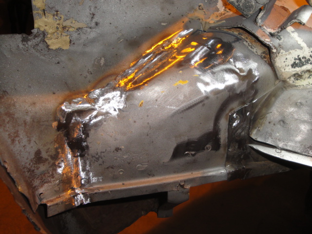

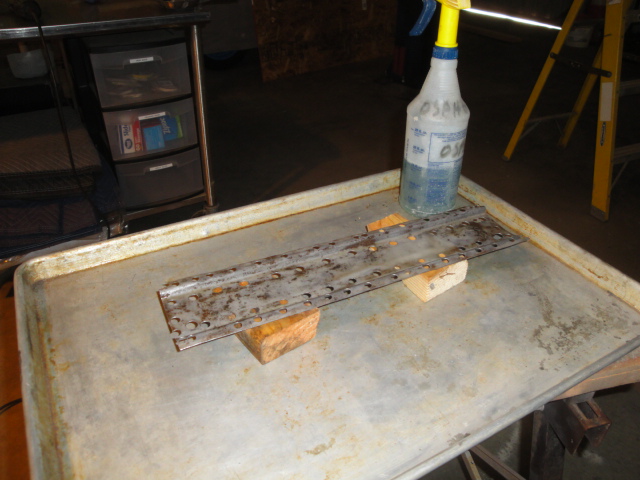

Started the day with grinding down the inside trunk corner patches. After the grinding and sanding was finished I coated them with cold galvanizing.
While cold galvanizing was drying I sprayed down the trunk support panel with OSPHO. Getting it ready for a rub down with a red scour pad and an application of cold galvanizing.

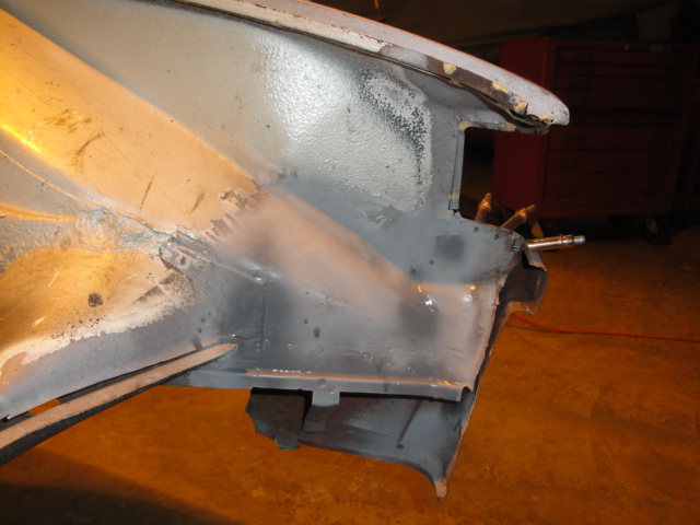

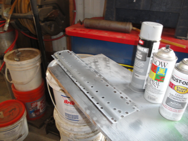

Took a couple minutes and tidied up the OSPHO and gave the panel a layer of cold galvanizing.
