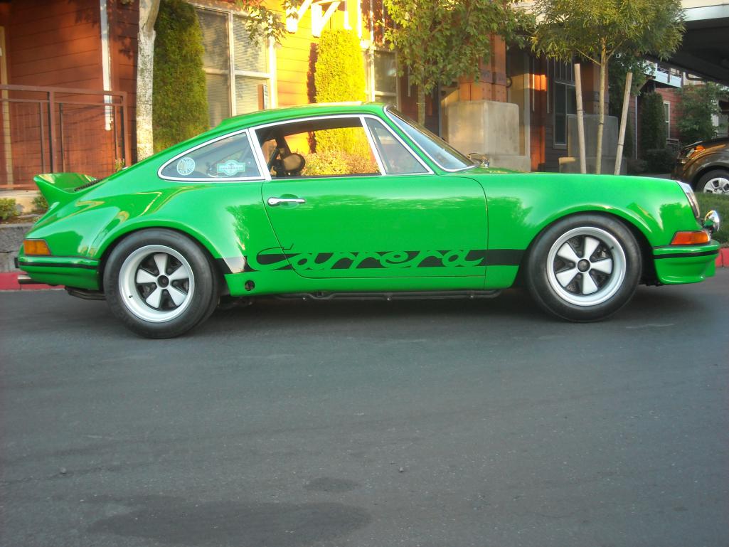

Just lookin' to build a killer 4 cylinder 914 that is factory race look.
I'll show you what I've got in mind over the coming months.
BTW....this was my attempt with a 911.
