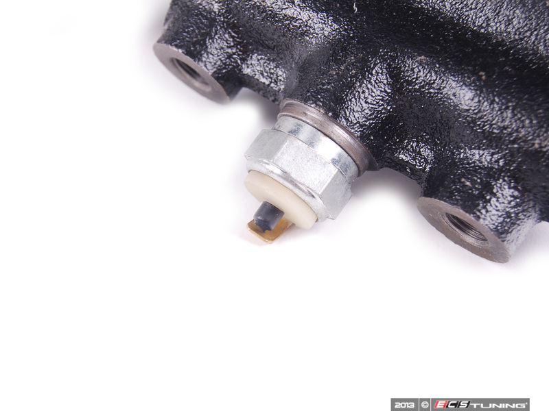

Just reworked my entire brake system with help from PMB Performance. Replaced the master cylinder as well. I too had the persistent "brake" light flashing/alarm and didn't know how to remedy the situation. Was told by Eric at PMB that I needed to reset the switch. Since I had the car up on stands I could easily get to the master cylinder again. Removed the boot protecting the two electrical wires. Adjacent to the two electrical posts is the switch, not really a switch since all you have to do is push it in. It is only a protrudence of plastic and not easily recognized as a switch. Push on it while the key is turned to the on position. You will hear the cessation of the brake alarm. The brake light will stop blinking. Easy. I've had to do this twice now once with the car on the ground.

It is the black "shaft" in this picture.
