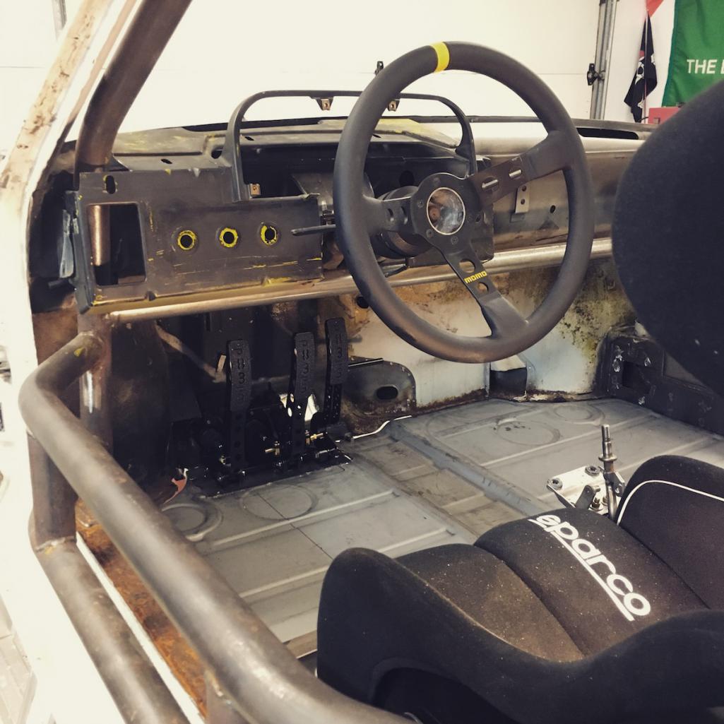

- mocked up the floors and Wilwood pedal cluster, looking good so far

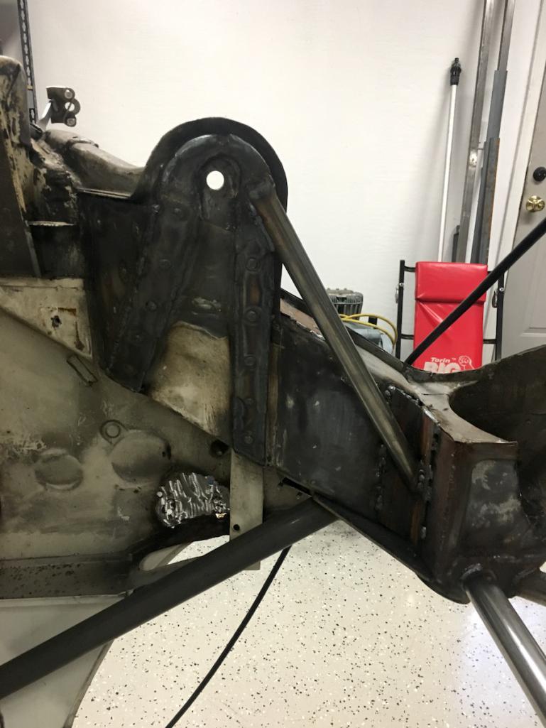

- reinforced the rear suspension consoles. its not the most /technical/ solution, but I think it'll work

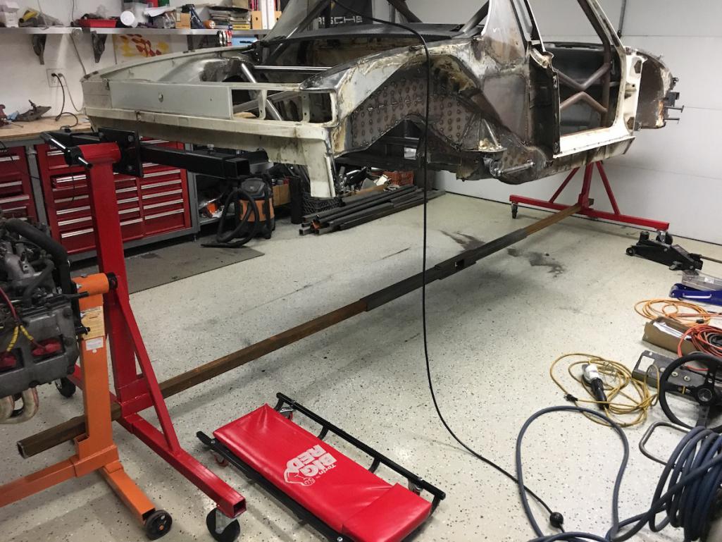

- rebuilt the rotisserie with a center connector and better wheels, should be able to get it onto a trailer now

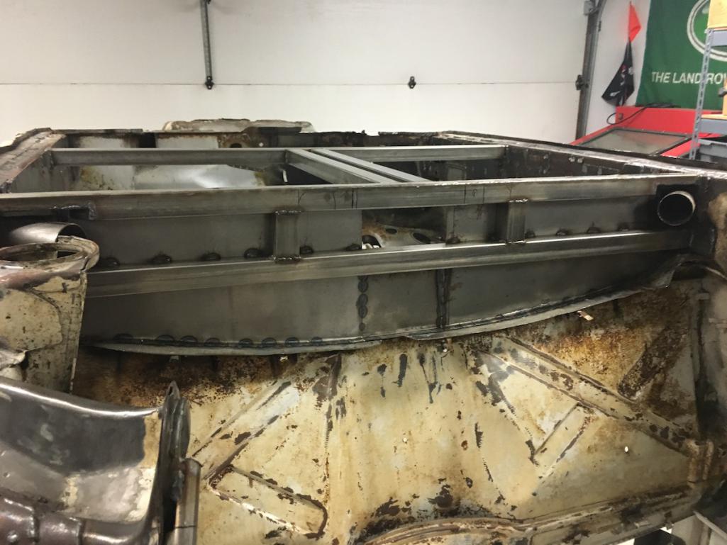

- finished up a bit more of the rear firewall
