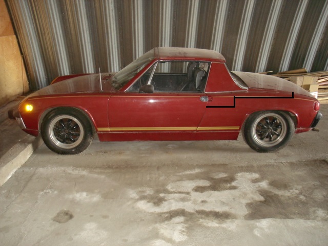

Here's what I'm thinking (see pic below). Given that I don't yet have replacement fenders and so don't know what I'll be working with, would it be wise to cut on the line indicated in the pic in case I end up having to graft in new fenders rather than a full replacement? Is there a better place to cut?
