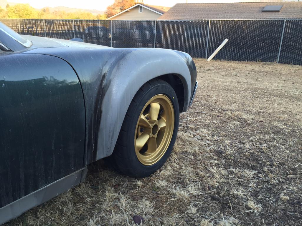

the first guy i tried to use for the flare install turned out to be a huge jerk-off. finally got them installed by an R-Gruppe friend, thanks Bob.
got the front wheels finished.

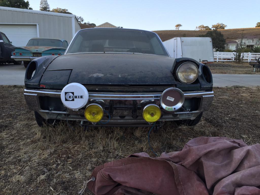

and mounted a few lights. the Cibie is just a place holder. i have a set of Marchal driving lights like the one on the right, i was just waiting for the second clear bulb to arrive.
waiting for some headlight adjuster parts to come and then fresh headlights will go on.

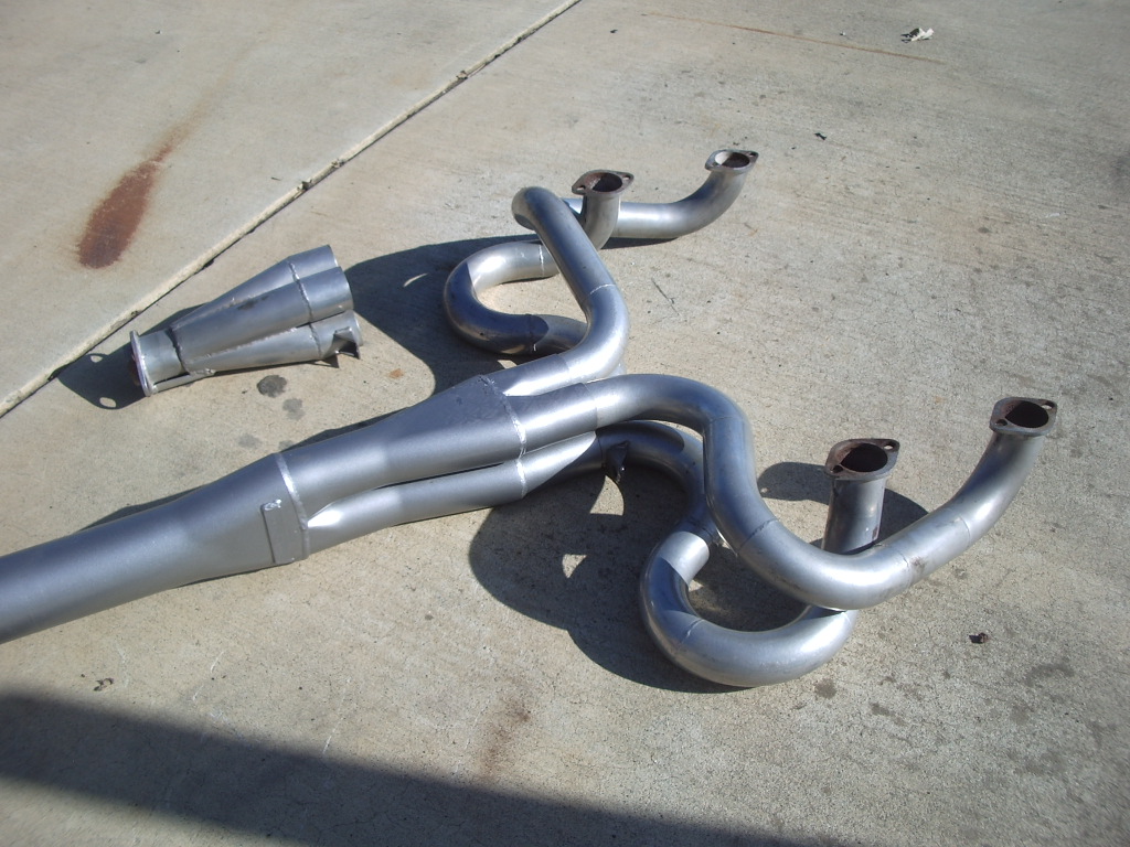

next up buy some bumper rubbers and get the race exhaust installed.
