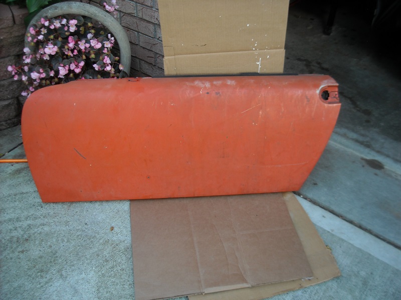

I worked through a few more setbacks. First when I finally started to strip off the doors to get them ready to take and be blasted I discovered that the drivers door was hammered. someone did a pretty good job of hiding the work and it stayed hidden for the 37 years I owned the car. but I didn't think it was worth my time to try and fix this mess. These are some of those rare doors, 9-72 thru 12-72 late window mechanism and no door bars. didn't think I was going to find another of those so....
so after checking out a couple doors a friend had, I contacted Garold and he picked me out a nice one.
they are at the blasters now then I will go to work on them.

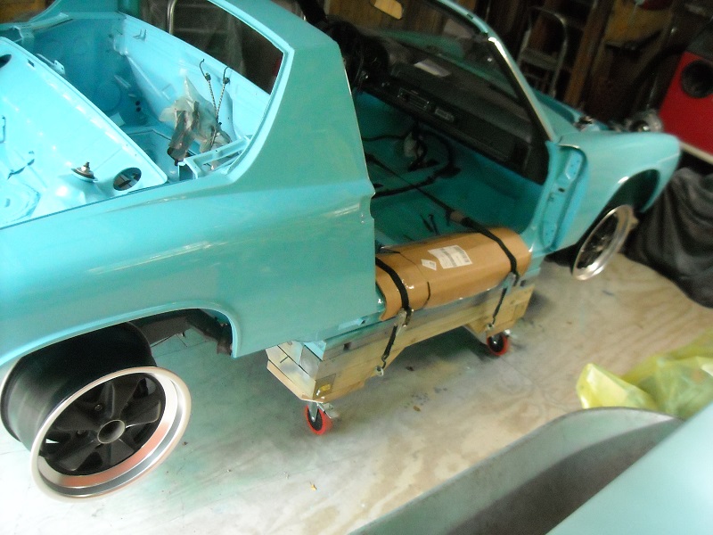

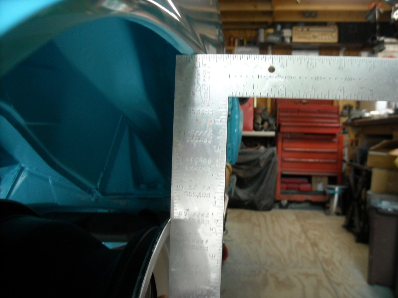

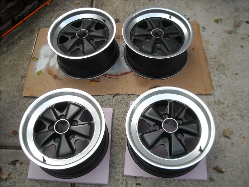

I wanted to get it on the ground and started to look at tires to fit the 7 and 8 in Fuchs I wanted to run. Well in spite of getting the fenders flared it looks like the 8 inchers may not work, even with 225 / 50 -16.
I really like these wheels though........
I have another idea but I will do a little more research before I decide what to run. But this will have to happen soon. I want to get it on the ground before I put the engine back in.

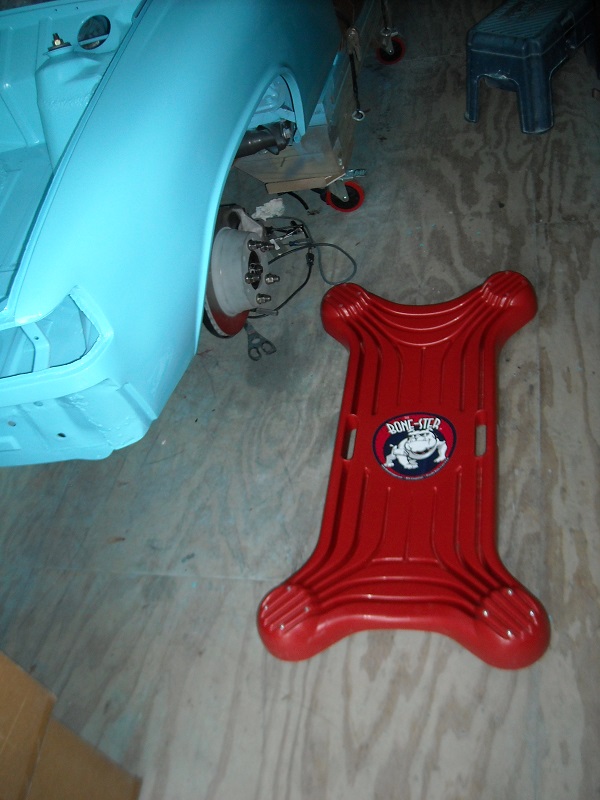

Spent 4 days working on the brakes. two days to finally get the system bled and two more to get the venting clearance tight and have a working parking brake. The brakes feel good now ( at least pressing on them in the garage) so I think I am good to go with that.

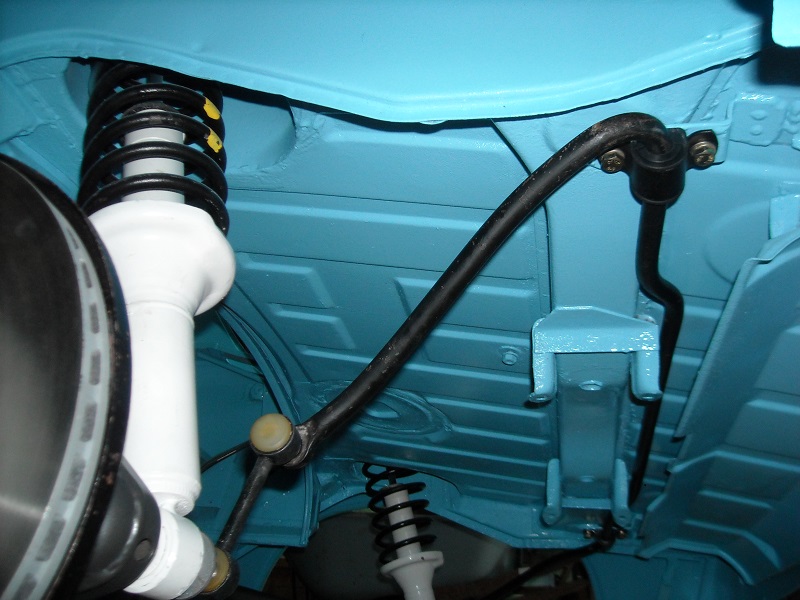

I got the rear sway bar mounted and picked up a new creeper... this thing is like a Magic Carpet the way it slides around, No more fighting with my old creeper to roll around, or it eating my shirt....
This really helped while working on the brakes.

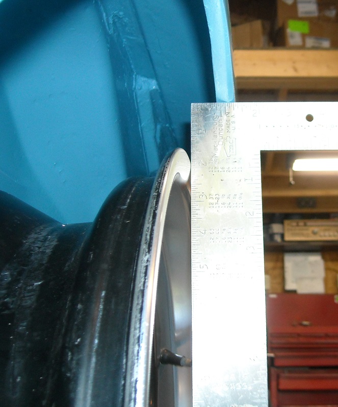

Still Moving along.
Tom
[/quote]

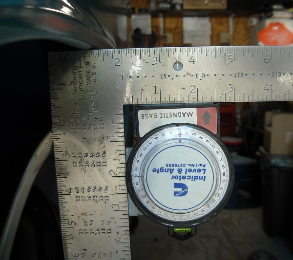

The way the trailing arm rotates will bring the wheel inboard slightly under load. Disconnect the Spring/shock with the wheel on and lift it up to a loaded position to see if fender clearance improves

[quote name='barefoot' date='Sep 20 2016, 06:51 AM' post='2400755']
Still Moving along.
Tom
[/quote]
[/quote]
Ok, This may work....
I leveled out my cart and disconnected the shock to enable it to move up to more of a running position and the clearance did increase. from 3/16 to about 3/4 inch. that should be enough to clear the 225/ 50 - 16 s
This is with 2 inch vertical from rim to fender lip. I really just guessed on the ride height.
presently there is a 2mm shim installed and my rough measurement shows it to be around 2 deg negative camber
So I may be able to stay with Plan A ,
Plan B involves different wheels and it would be better if I didn't have to go there...
