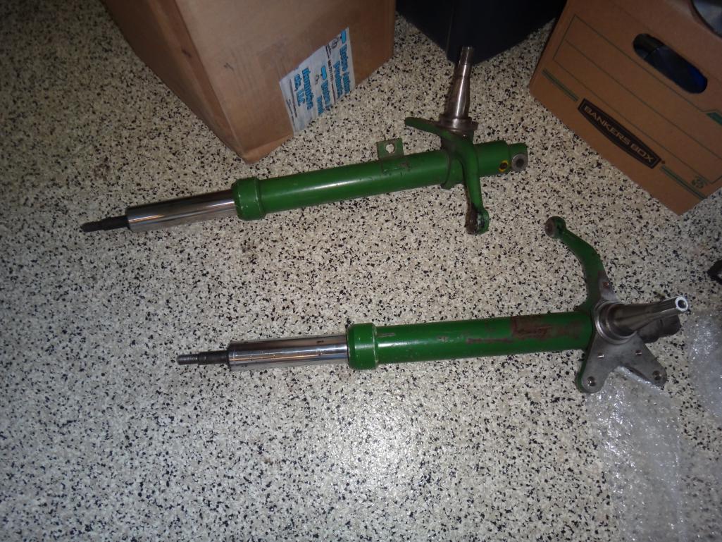

Some of the 911 conversion parts arrived today.
Bit the bullet as I know I would have received a lot of flak for keeping the 914-4 braking system with a 911 engine that will be making around 200hp.

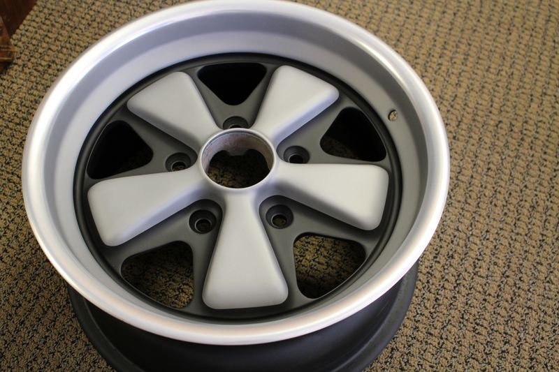

The upside is that I'll be able to take the car to the track....which I wouldn't have done previously.
Pity that I won't be able to use the killer 4 bolt Minilites, but I'm looking at a set of 15x6 deep (ET36) and 15x7R deep (ET49) replica Fuchs from Group 4 Wheels.
I'll get the wheels in bare aluminum and have them refinished in RSR style by these folks: http://forums.pelicanparts.com/porsche-911...gh-quality.html
Haven't put the order in for these yet.

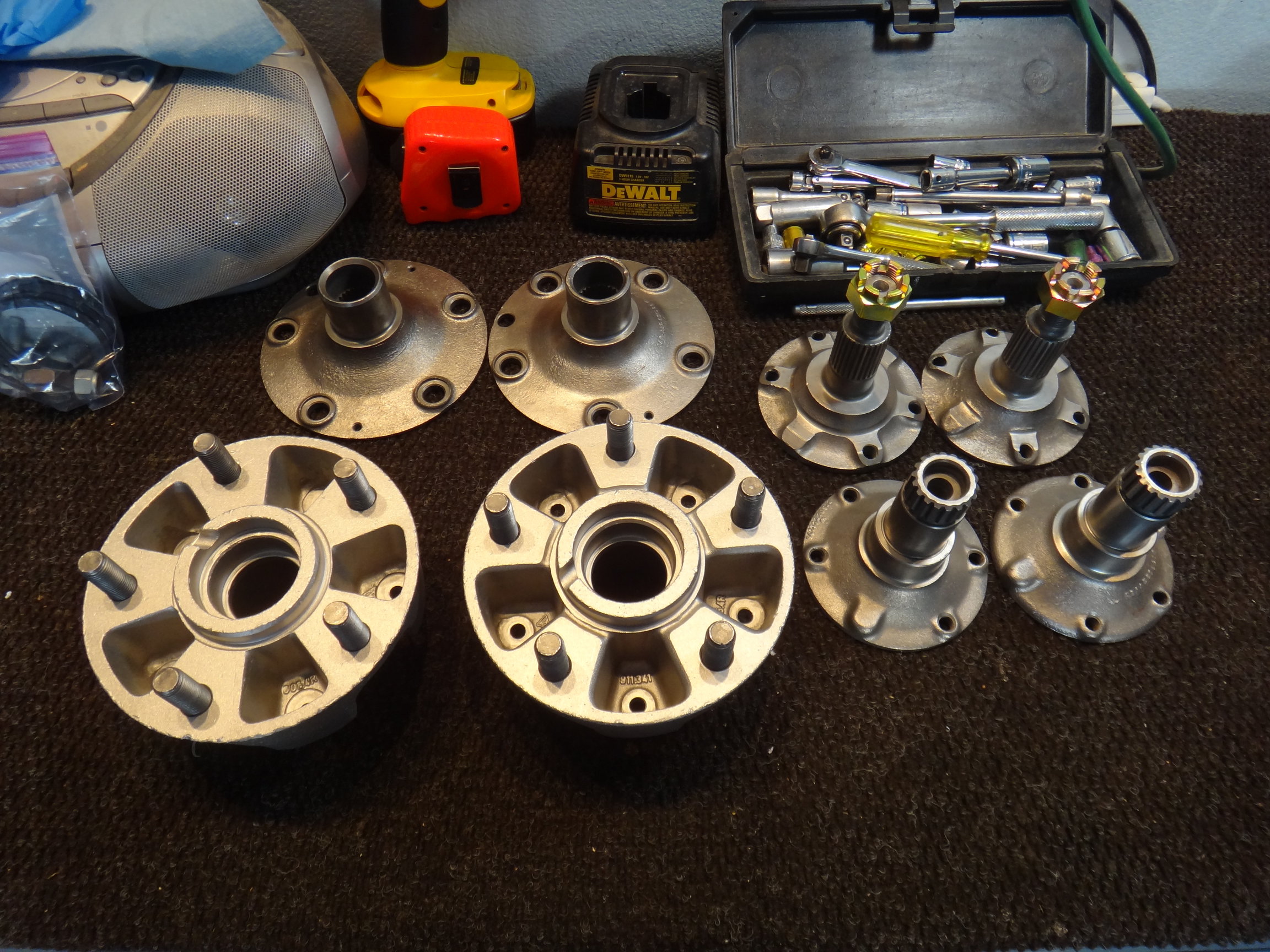

SC Bilstein struts and hubs. Dampers will be changed out for a set of Bilstein HD from Elephant Racing.

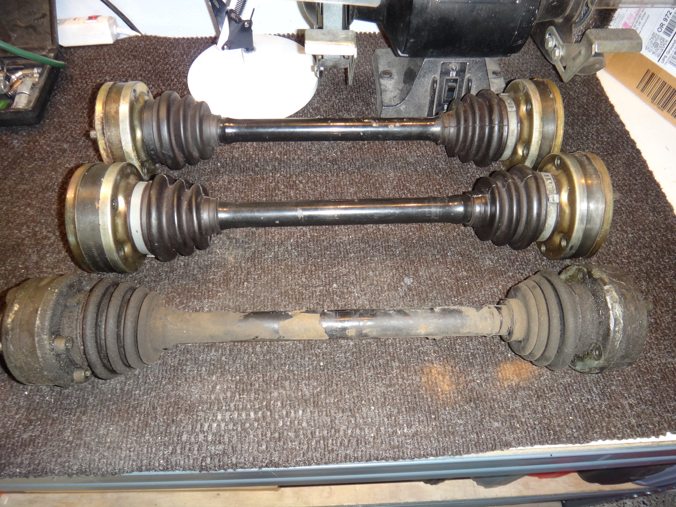

911 axles....you can see they are shorter than the 914 ones.
So I'll be doing the Sway-A-Way longer 930 axle conversion.
Trans flanges, 911 stub axles and rear hubs as well. Likely will be replated although they do look good currently.
All this came from Retro Automotive out of New Hampshire.
