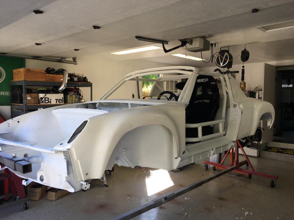

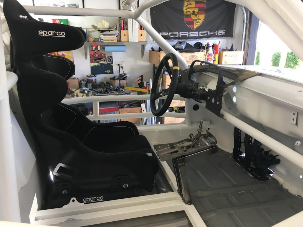

Well, the Build-Off Challenge is over but work continues at the MichiganMat house.
So whats new:

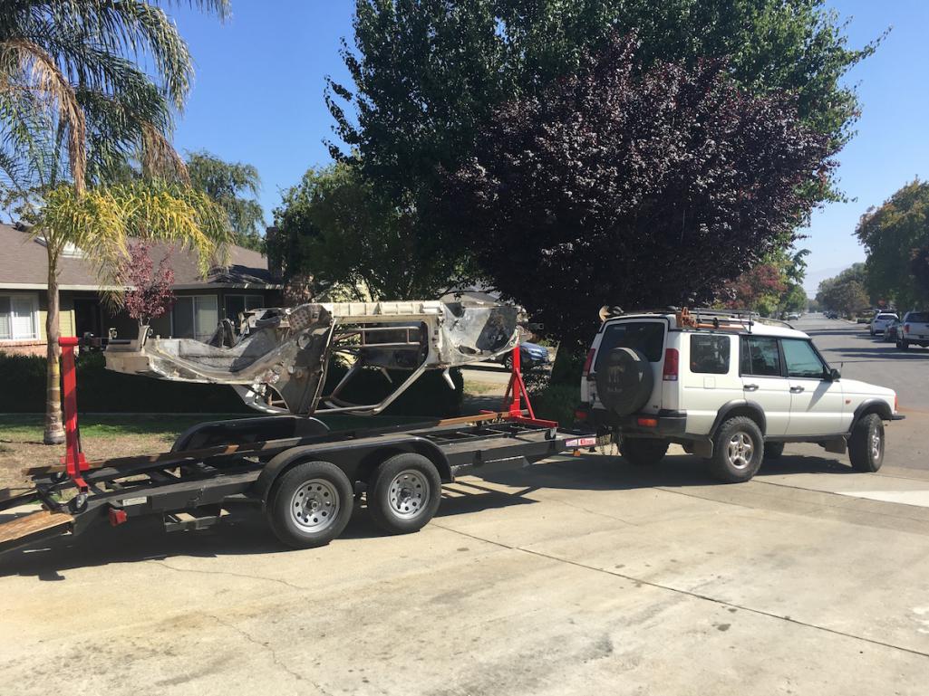

- Loaded up the trailer and took the car off to the blaster. Came back minty-fresh
- Pretty happy with the result, not too much blow-through from the blaster, chassis is pretty much ready to take to paint

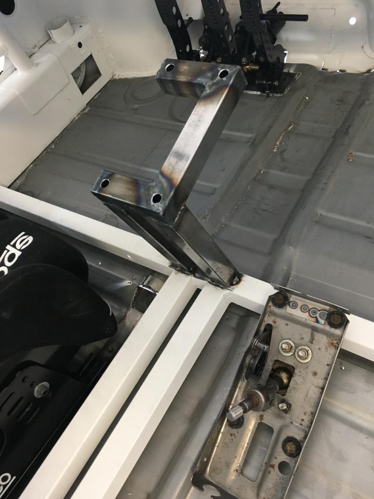

- Fully welded in the floor pans and the shifter console
- Liking the ergonomics, its coming along
I waited to install the pans before blasting on purpose. I wanted to make sure all the shitty stuff under the dash got a good blast. The pics don't show it but I also tied the pan into the center "tunnel" structure, its nice and firm now, structurally sound.
Next steps:
- Friend who loaned me the trailer is moving, so I gotta get this thing off to paint ASAP.
- I need weld in some tabs for the dash, weld in mounts for the passenger rocker, and seam-seal the driver compartment, and then I get off to paint.
- I expect to be at painter in the next two weeks.
