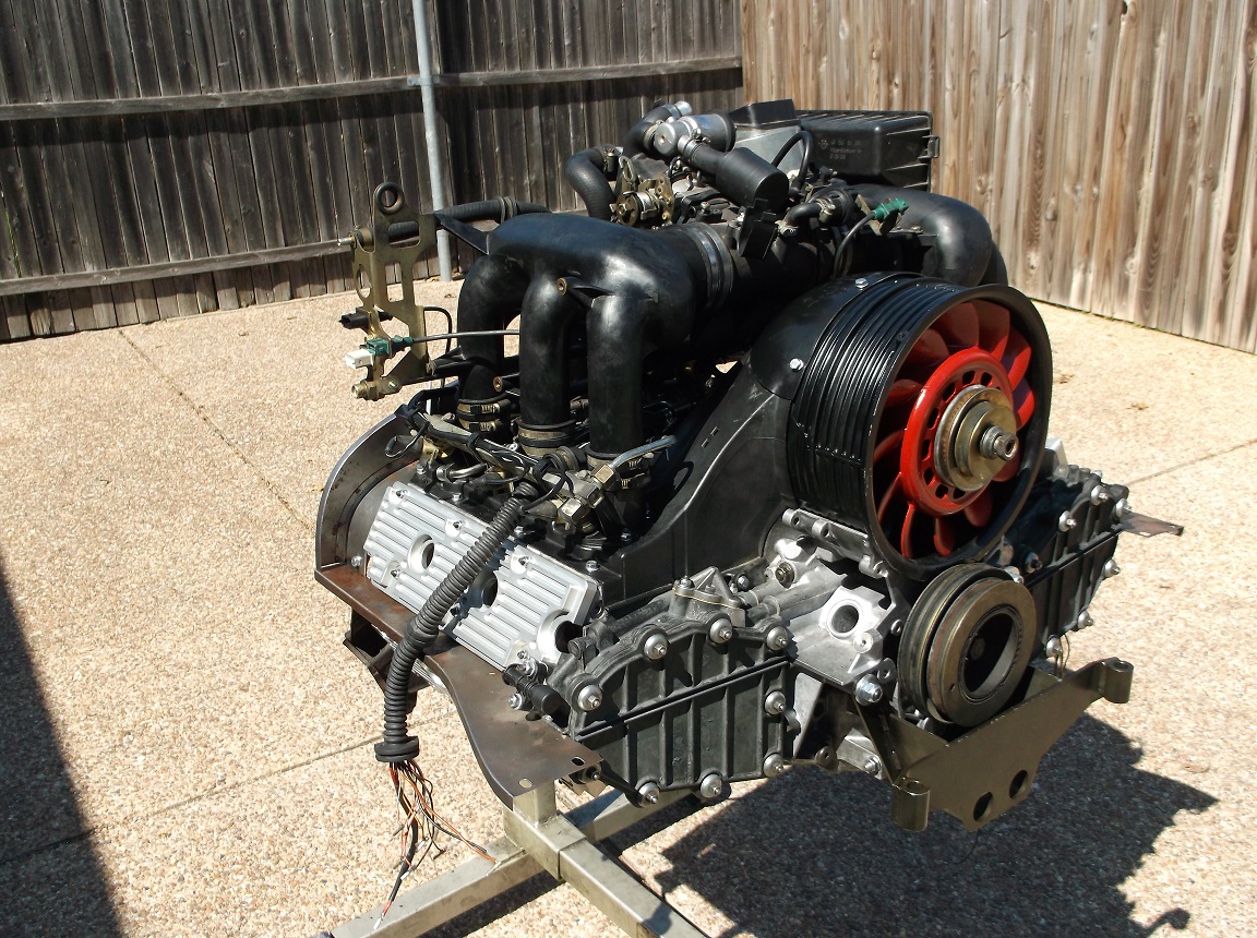

It begins:
Just arrived from Hawaii...
3.6L 964 motor. Destined to become a 4.0L with 993 RS cams. I am keeping the FI so it is a bit more drivable than the MFI motor I have now.
I actually started this years ago. I bought a 3.6, but it turned out to be unusable. But I had already bought the LN engineering pistons, cylinders, rods and stud kit to make it a 4.0. So now I get to use all that stuff!.

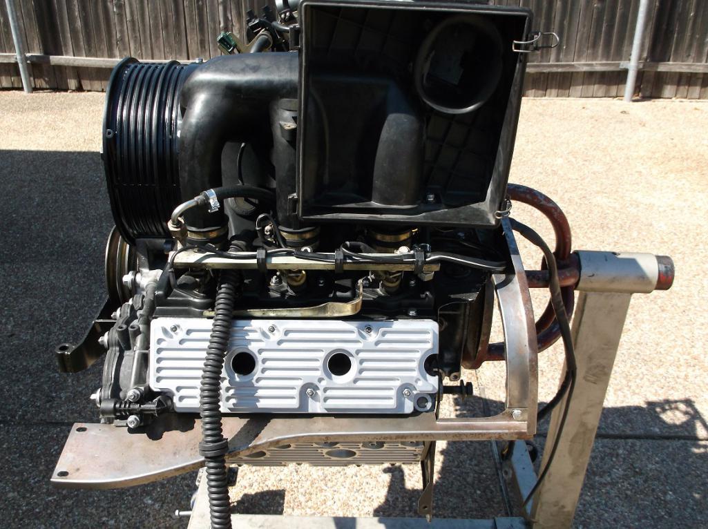

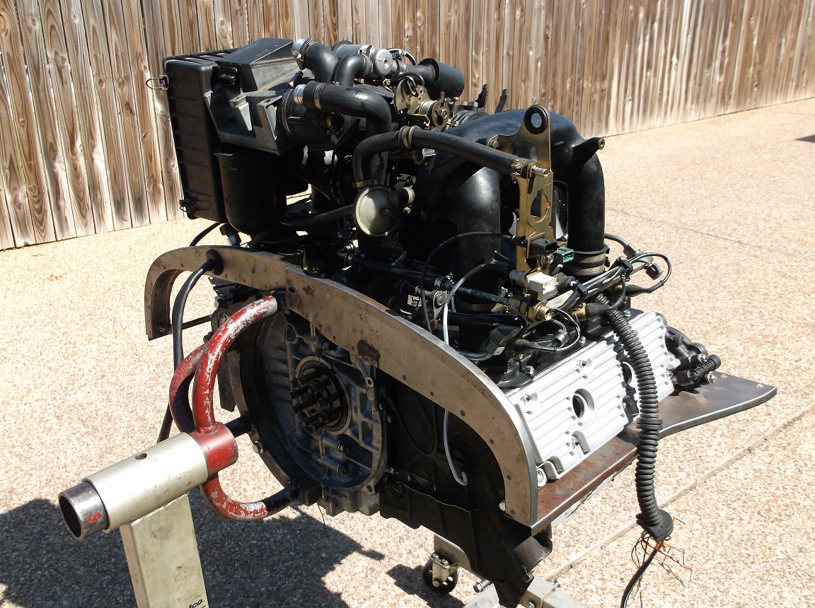

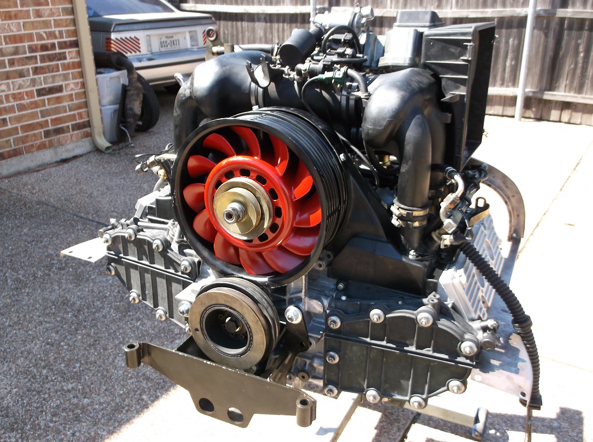

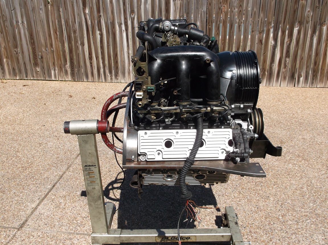

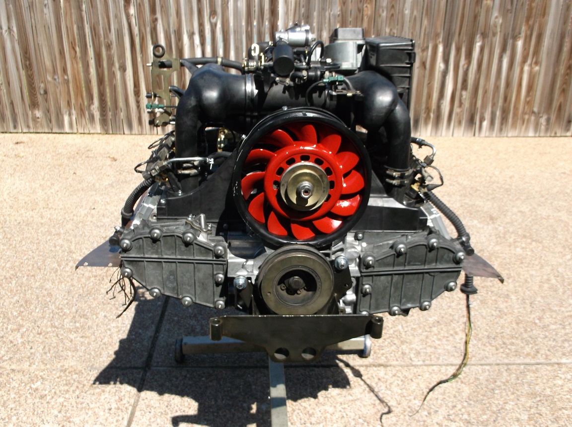

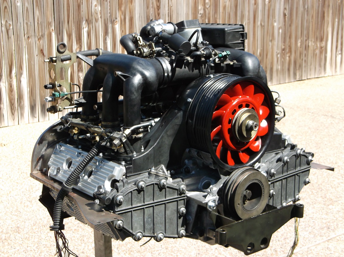

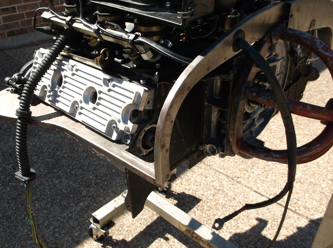

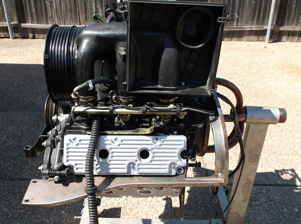

I have not updated this thread in a while.
But here is the progress...
Betty was trying to convince me to paint the valve covers red. I like them in the natural aluminum.
Should I start a poll paint/no paint?

raynekat   Big no on the red paint. Keep it as much factory l...   Oct 1 2016, 12:30 PM
mepstein   Big no on the red paint. Keep it as much factory ...   Oct 1 2016, 12:37 PM
914forme   Clear them Paint or Powdercoat the engine tin, un...   Oct 1 2016, 12:30 PM
ClayPerrine   Clear them Paint or Powdercoat the engine tin, u...   Oct 1 2016, 12:48 PM
