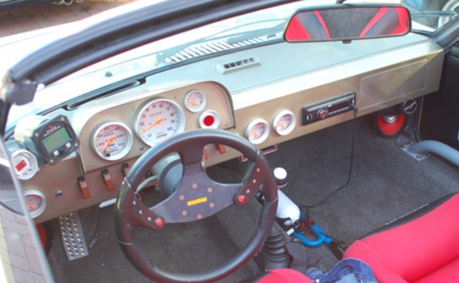

Very nice indeed.
I like this treatment,tho a dark matte coating or anodizing would avoid reflections in the windscreen.
Still,a nice effect,fighter jet.I worked in cnc punching and diemaking in the early '90s,mil spec enclosures.
https://www.google.ca/search?q=sheet+metal+...YceCsoQ_AUIBigB
https://www.google.ca/search?q=cnc+sheet+me...95zk1M9p6w0M%3A
For those sheetmetal and monocoque needs,a perfectly folded and punched fabrication.
Plasma cutters,lasers,waterjets too.
Like sheetmetal origami.
A local guy with a hobby cnc router could cut that metal in a jiffy,and at good quality.

R_u_dd   [b]Gauges, Gauges and More Gauges The original lo...   Oct 2 2016, 02:04 PM
