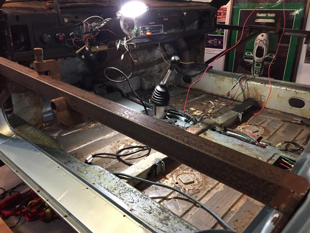

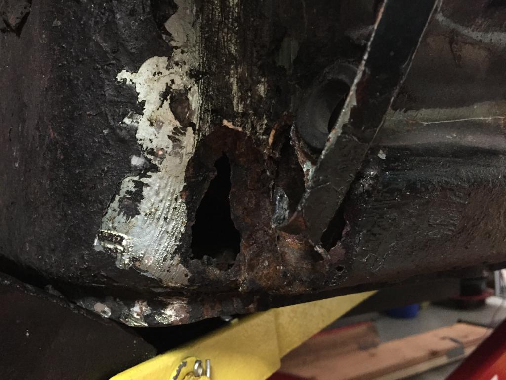

Well I've started the process of preparing for
my 2056 GT to 2.4L six "rallye tribute" auto.
Tearing into the interior I discovered some rust mites have been eating for a while.
Doesn't look too extensive but will be probing some more. The exterior left long was
patched a long time ago, albeit incorrectly. This was done by shop
that wasn't fully up to speed on these cars and I was still a novice, well
still am. I'll be doing some exploratory surgery on this left side inside and out. So I'll get this addressed before any engine install takes place. Would like to
have it buttoned up for Hershey 2017. Wish me luck.

Ok, tar all scraped out. Door braces in place.
Time this week to start cutting and removing the
offending rust areas on the longs.

mepstein   Doesn't look bad. Grab a multi tool and get ri...   Sep 9 2016, 11:16 AM
914dave   Doesn't look bad. Grab a multi tool and get r...   Sep 9 2016, 11:47 AM
rgalla9146   Doesn't look bad. Grab a multi tool and get ...   Sep 9 2016, 12:25 PM
mepstein   [quote name='914dave' post='2396059' date='Sep 9 ...   Sep 9 2016, 12:32 PM
Dion   I intend to Mark. As always Dave has my back! ...   Sep 9 2016, 12:16 PM
Dion   At what point do I go to Earl Schreib & Zeibar...   Sep 9 2016, 12:49 PM
914dave   Right after the foil. If you want it proper.   Sep 9 2016, 01:10 PM
mepstein   All you need to do a pro repair- no metal work...   Sep 9 2016, 01:43 PM
Dion   I knew this club would payoff in its wealth of kno...   Sep 9 2016, 02:54 PM
flippa   It's a VW. The proper method is to steal som...   Sep 9 2016, 04:22 PM
wndsnd   It's a VW. The proper method is to steal so...   Sep 9 2016, 05:23 PM
bretth   What, no pop rivets? :huh: Yeah one pop rivet o...   Sep 9 2016, 05:14 PM
Dion   You guys are great. This is gonna be fun. :beer3:   Sep 9 2016, 05:30 PM
jmitro   looks like you got a little work to do. Good luck...   Sep 9 2016, 07:56 PM
rgalla9146   Paint it Red. Very important.   Sep 10 2016, 03:25 AM
cary   The problem your going to run into is the degradat...   Sep 10 2016, 08:10 AM
Dion   Hey Cary, The jack point was completely cut out....   Sep 10 2016, 10:25 AM
