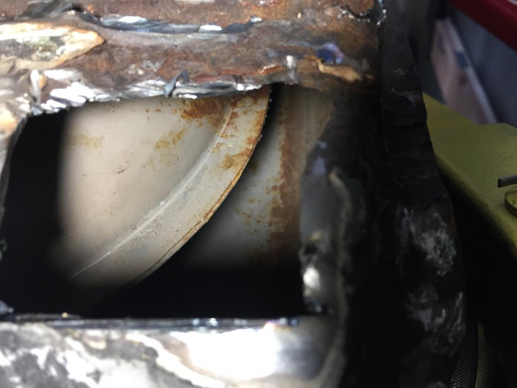

Well I've started the process of preparing for
my 2056 GT to 2.4L six "rallye tribute" auto.
Tearing into the interior I discovered some rust mites have been eating for a while.
Doesn't look too extensive but will be probing some more. The exterior left long was
patched a long time ago, albeit incorrectly. This was done by shop
that wasn't fully up to speed on these cars and I was still a novice, well
still am. I'll be doing some exploratory surgery on this left side inside and out. So I'll get this addressed before any engine install takes place. Would like to
have it buttoned up for Hershey 2017. Wish me luck.

Well did more exploratory surgery and it's ugly. Beauty on
the left side was in fact only skin deep. Consulted with my
bro Dave ( 914Dave ). So time to cut out the outer long complete.
To the kickup and replace the metal accordingly. Inside the cabin
area can be fixed with a few patches. Floor is in good shape remarkably.
I should just enter the buildoff at this point (IMG:style_emoticons/default/biggrin.gif)
Stay tuned...
