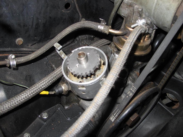

As I tend to be, I am so far ahead of myself it is not even funny. Just got email that my MicroSquirt was delivered and was left on the front porch. So I am all ready looking at jumping to the ignition and sequential injection timing and I have not even opened the first box yet!
For my engine I think I will be spending most of my time below the 4K mark so the sequential fuel injection is desirable to me but obviously not a requirement.
But I would like to go to a more modern coil set up and have the ability to control my timing. If there is a dizzy based option to control the timing I would be good with that and let the sequential go.
Something like this seems perfect but not sure where to find. Attached Image
