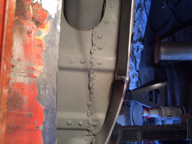

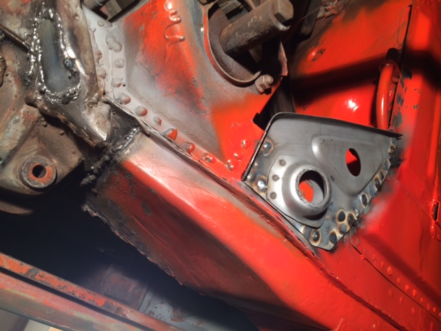

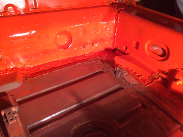

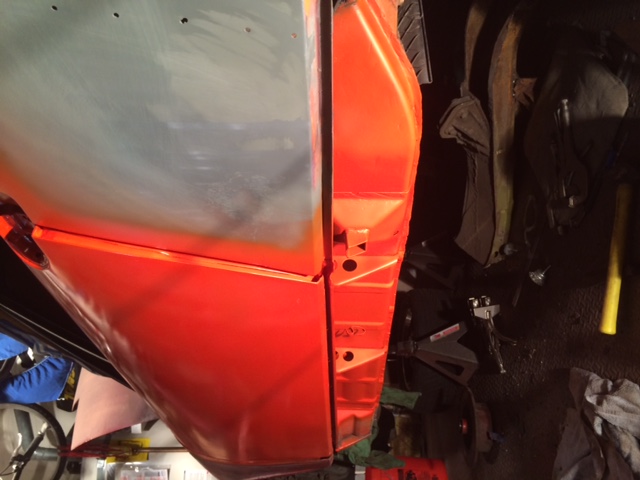

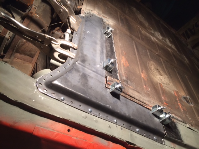

Oh, OSPHO or other rust remover can be used to arrest rust when you're in there, it leaves a phosphate coating behind after rinsing that helps prevent rust. Once dry, a good weld through primer or even cold galvanizing spray can be used between the layers, but you do have to wire wheel where your going to weld. Once welded. wire wheel all to bright shiny metal, OSPHO again to basically etch the steel, rinse, fully dry, and then prime with your choice. I often use self etching primer in rattle cans because it is very convenient, but many opt for an epoxy primer which many regard as the best. I don't plan for this car to even see rain. Here's a few more shots that help explain my repair and stiffening.Attached Image Attached ImageAttached ImageAttached Image[attachmentid=576
